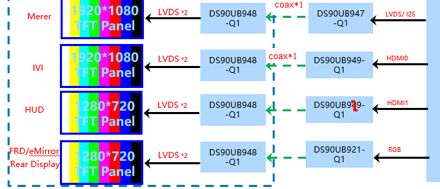

DS90UB947-Q1: if DS90UB947/949 coax mode support 1080p panel?
Part Number: DS90UB947-Q1
does the block diagram workable?
  • Hello Drina,
    Could you please let us know the framerate of your full HD displays (Merer and IVI) ? Also, what's the timeline for your project ?
    For 30FPS, then the Pixel Clock would be ~= 1920 x 1080 x 30FPS + blanking (~20% typ) = 75MHz --> ok for single lane support (single coax)
    For 30FPS, PCLK would double, ~150MHz, and you need dual coax, or STQ cable support.
