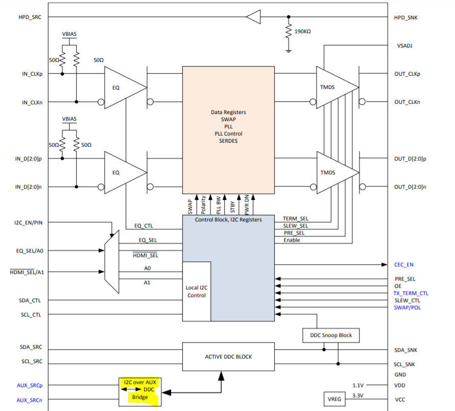

Hi Team,
I'd like to know what's the using scenario of I2C-over-AUX so I can choose between the RGZ and RSB package.
Thanks.
Roy
Roy
A Dual-mode DisplayPort Sources may access the DP159 Type 2 cable adaptor registers using either DDC signaling or I2C-over-AUX signaling. So it is up to the source on which interface (DDC, AUX, or both) it can support.
