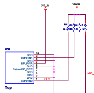

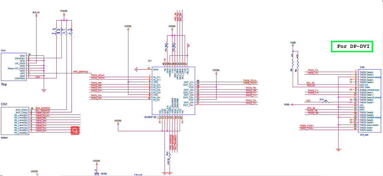

        The following picture is the schematic.We want to know why the issue will happens in specific platform.If it's a compatibility issue. Can TI offer the method to solve this issue ? Thank you!
    For DVI application, can you have I2C_EN pulled low? Have you tried different SRC and Vsadj settings?

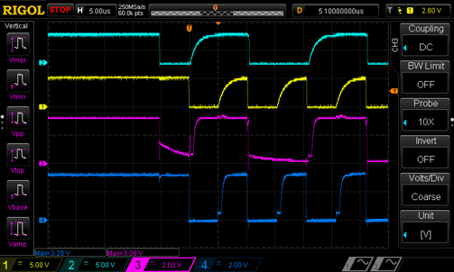

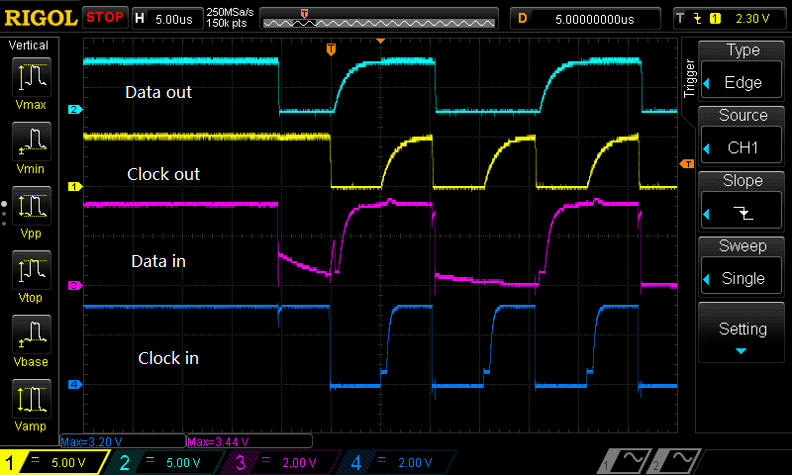

  • Hi David ,
          The cable which length is 1.8m can also work normally besides the specific platform (Lenovo M720S、M720Q,Groplics UHD 630,Intel:,i7-8700,Windows10,Enterprise LTSC).
          Customer also tested the waveform between normals and failures and found there is a difference in the waveform of Clock_in.Please see the picture-1 and picture-2 . And customer thinks the "noise" looks more like crosstalk from Aux channel
                                                           Picture.1 Normals
                                                                         Picture-2. Failures
           Base the "noise",customer tried to change the pull-up resistor to 4.3kΩ(The previous value is 100kΩ). And the cable (1.8m) can work normally .The picture-3 is the waveform .
                                                                                                          Picture.3
                                                                                                        Picture.4 modify
           But Config1 resistor should be 100K per standard. This is just an experiment to illustrate that the DDC can be improved by lowering the Config1 resistor value. It does not explain why the working cable can work without changing the Config1 resistor.

    Looking at the layout, I don't see how the DDC could cause crosstalk on the CLOCK input since they are not routed next to each other on the board. I am concerned with the signal being routed on the bottom of the board as it appears that they are routed across broken plane. I am also concerned that when route from the top layer to the bottom layer, there is no GND via next to the signal via to provide a signal return path.
    I also don't understand how changing the CONFIG1 from 100k to 4.3k could fix the issue. If you change the resistor back from 4.3k to 100k, does the issue show up again?
    Also, for CN1, CN3, and CN5, where is the shield ground? CN1. CN3, and CN5 all look to be surface mounted connector. You would need a shield ground to provide mechanical stability.

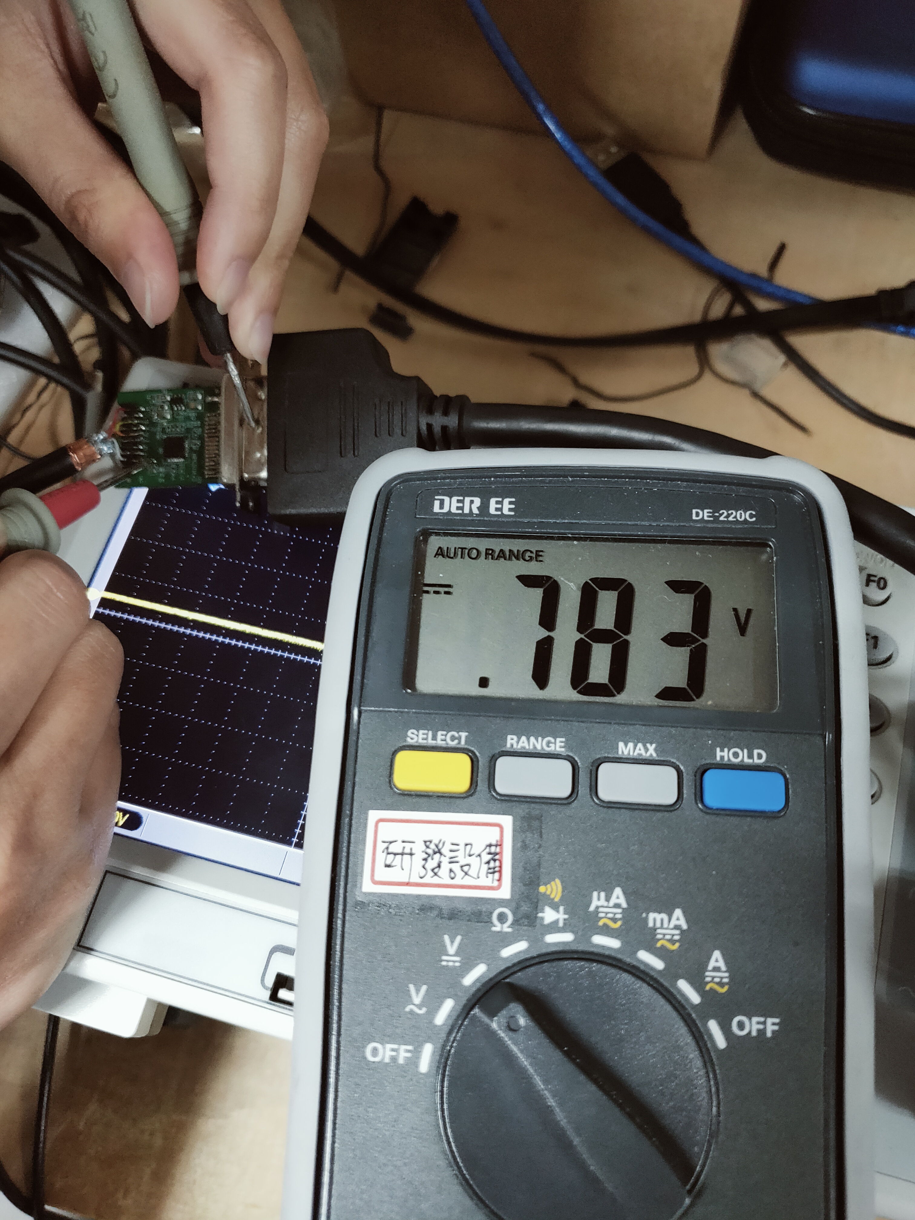

  • Hi David ,
             It's repeatable. The Config1 voltage is the same in both working playform and failing playform. The voltage is 2V with 4.3k resistor and the other voltage is 0.783V with 100k resistior. Are there some risks if changing the resistor to 4.7k?
    Thanks for the voltage measurement.
    Per the DP++ spec, the voltage on CONFIG1 needs to be above VIH for the cable adaptor to be recognized. The VIH is defined as MIN of 0.7*DP_PWR and MAX of DP_PWR_Max.
    If the voltage is 0.783V with a 100k resistor, then this voltage is below the VIH. The DP++ source will not recognize DP139 as a DP++ adaptor and outputs DP signal only. DP139 will not work with a DP signaling output.
    A 4.7k is a stronger resistor comparing against the 100k resistor. I think you need to understand why the voltage is being pulled low with the 100k resistor with these particular failing platform.

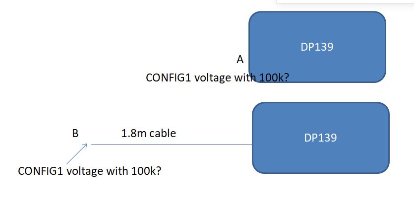

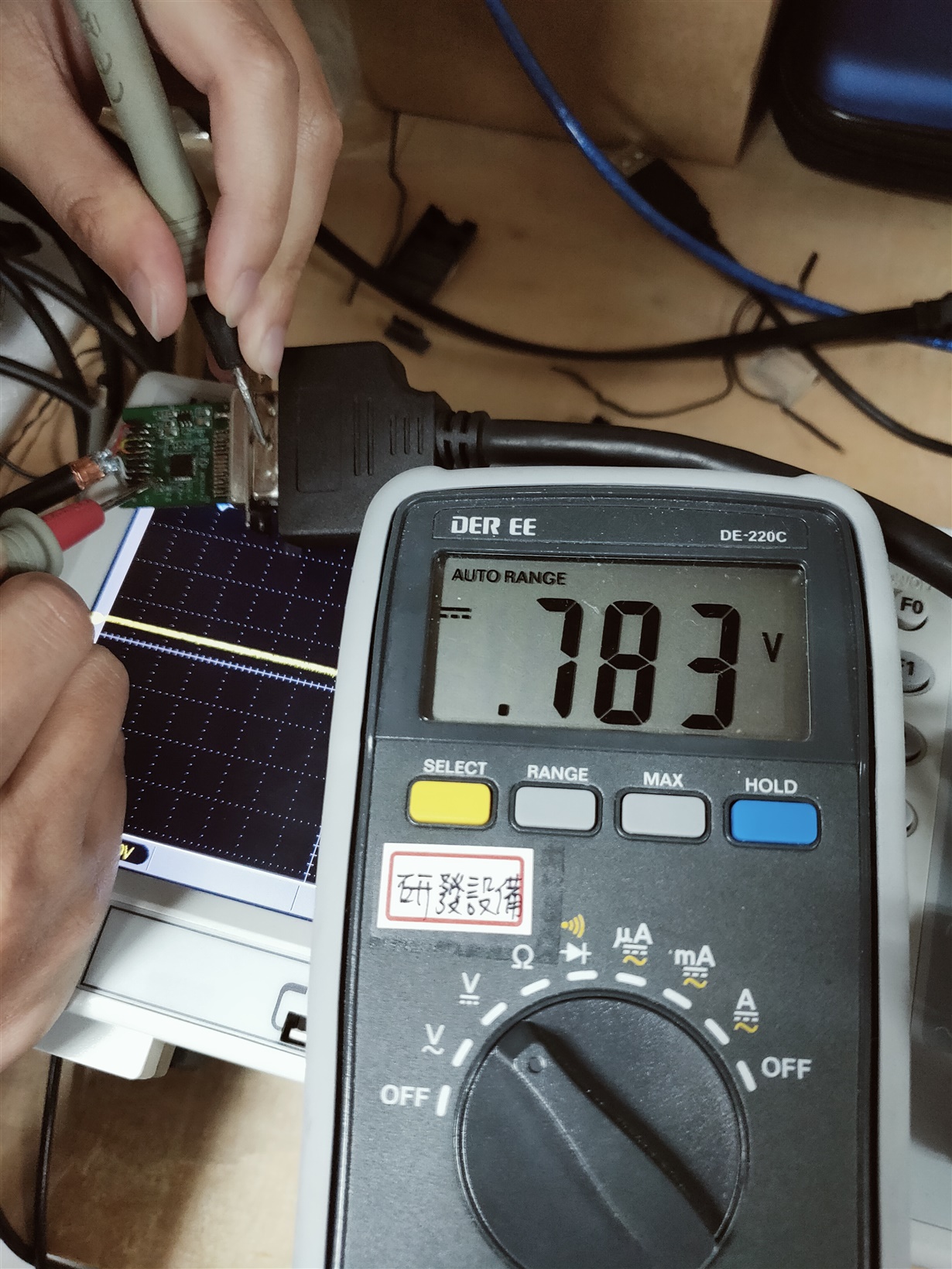

    With 100k resistor, can you please measure the voltage at point A and B as shown below?
    David
  • HI David,
    Voltage measurement is Unchanged,
    Can you measure the voltage with the DVI cable is removed but CN1 and CN3 connected?
    Can you also measure the voltage when DVI, CN1 and CN3 removes?
    David
  • HI David,
  • HI ,
    No voltage, no DVI plugged in
    no can't move CN1,CN3 ,is gold pin
