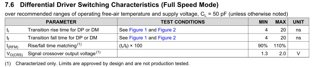

The customer operates this device at Full-Speed 12Mbps.
If they want to check the eye requirement, is it base on below spec.?

Hi Kevin,

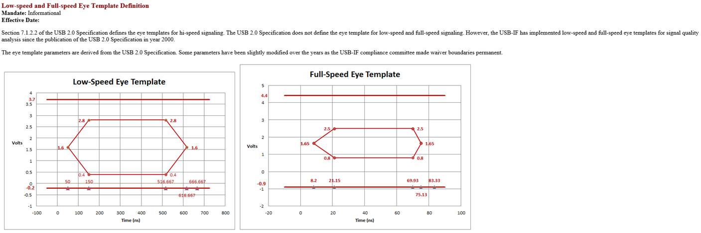

Yes, that is the correct section of the datasheet. There is a full speed eye template defined here: https://compliance.usb.org/index.asp?UpdateFile=Electrical&Format=Standard
You will need to scroll down to see it.
A FS eye on the downstream port is taken with a regular SOF packet, not a USB test packet.
