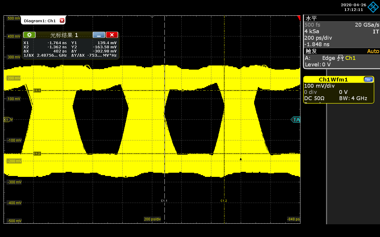

Hi Team,
In datasheet, it doesn't note min andmax, only has typical value.
May I ask whether this eye diagram meet the requirement?
Thanks!

Hello Amelie,
In order to qualify system margin with 948, our suggestion is to use the Margin Analysis Program instead of CMLOUT. You can find more information on that here:
https://www.ti.com/lit/ug/snlu243/snlu243.pdf
http://www.ti.com/lit/pdf/snla301
