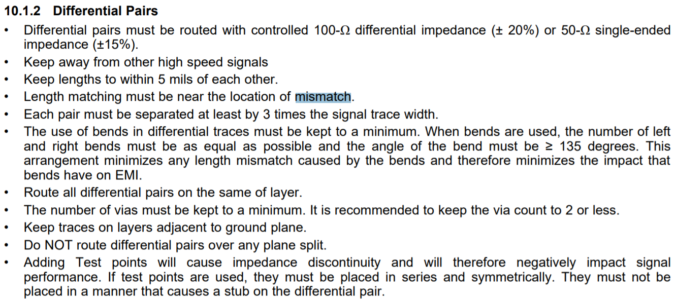

Hello expert,
My customer is asking for layout guideline on differential pair. We found some guideline on datasheet for 5mil lengths of each other, away form high speed signals... etc. But we didn't find the guideline for two group differential pairs mismatch limitation. We would like to know total length on pair 1 and pair 2 cannot be over XX mils. Thanks a lot!
