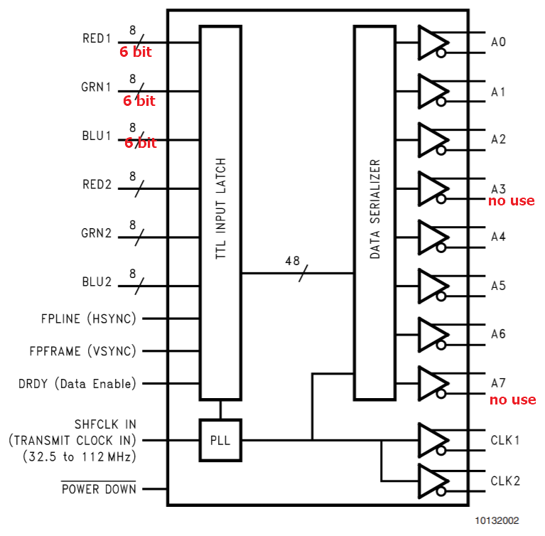

Dear team,
My customer has a new demand, and the conditions are: single pixel 18bit RGB666 input, dual pixel LVDS output. About the LVDS output, they only use A0/A1/A2, A4/A5/A6, CLK1/CLK2, but they don't use A3 & A7. Is it feasible? If not, do we have other device which can meet such requirements?(Each LVDS port's pixel frequency is 48MHz)

  • Hi Sherry,
    Let me just confirm you are trying to have 2 input sources of RGB666 and output them over 2 LVDS with 3 lanes diff pair and both clk lanes?
    if this is correct all you need to do is not connect the 2 MSB of the Red(R16,R17 and R26, R27) Green(G16,G17 and G26, G27) and Blue(B16,B17 and B26, B27) for both inputs and not connect the lane A3 and A7.

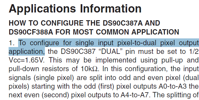

  • Hi Michael,
    In the customer's old project,
    Input: RGB888 on port 1 and nothing on port 2;
    Ouput: A0-A3, A4-A7 and CLK1 and CLK2.
    The customer choose single input pixel to dual pixel output mode of DS90C387A. And it works well.

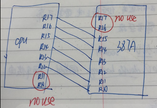

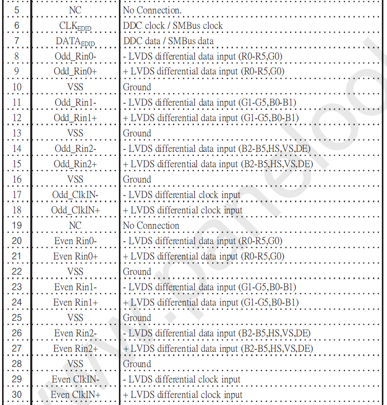

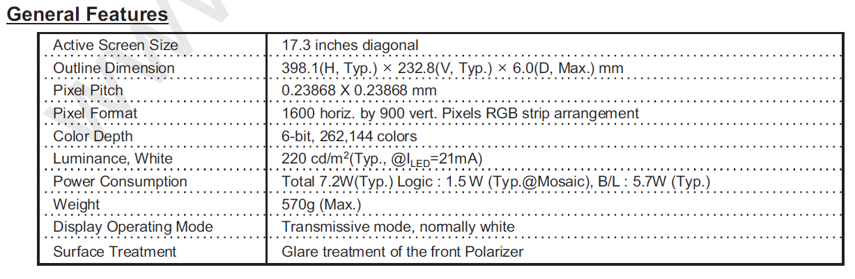

    Now the customer has a new screen, and the requirements are as below,
    Input: RGB666 on port 1 and nothing on port 2, but the customer's CPU only support RGB888 mode. The customer plans to abandon CPU‘s 2 LSB, and only use R12-R17, G12-G17 and B12-B17. In this way they will miss 2 LSB information.
    Output: A0-A2, A4-A6 and CLK1 and CLK2.
    Is this feasible? Below is the screen's datasheet.
    Thanks & Best Regards,
    Sherry
  • Hi Sherry,
    Yes, Your analysis is correct. This system should work.
    Michael W.
  • Hi Michael,
    Thanks for your reply! Yes, the customer test it in this way, and it works.
