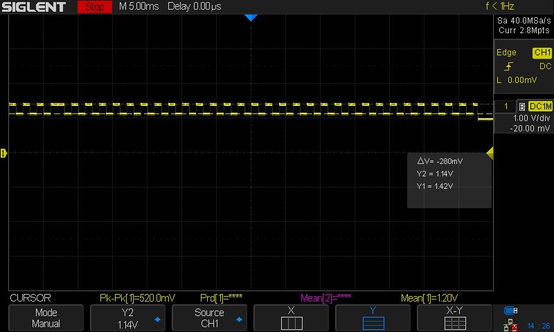

I am guessing about a solution with my TUSB4041I application. When I connect the device to the USB port i have "Unknown USB Device: device descriptor request failed".
With the oscilloscope i can see that the device tries to start up the crystal with multiple square pulses at very low frequencies (see attached img) but it won't oscillate.
I am quite sure about the load capacitance calculation and i also tried many values without getting to a solution.
It seems like the device is trying to do a test on the crystal peripheral or something like this.
Is there anything else that can cause problems to the crystal? The datasheet says that it has to oscillate at 1.8V but the charge pump loads the crystal at a maximum of 1.42V.
