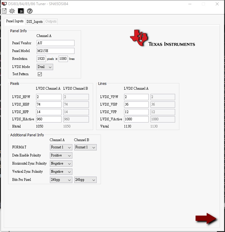

Hello experts,
Our NXP i.MX8MQ project uses the SN65DSI84 to convert MIPI to LVDS signals.
We tried to use DSI_Tuners to generate all register setting and enable Reg-3ch = 0x10 to output test pattern, but it failed and the Reg-e5 = 0x7d.
We also tried to use DSICLK and REFCLK to do the same test, but the test pattern cannot be outputed to panel.
Could please help to review our settings.
(1) Is it correct for AU-M215H 1920 x 1080 panel parameters? (http://www.bfdisplay.fr/fiches-techniques/ecrans-tft/AUO%20-%20M215HTN01_V1.pdf)
LVDS_HPW = 2
LVDS_HBP = 74
LVDS_HFP = 14
LVDS_VPW = 2
LVDS_VBP = 36
LVDS_VFP = 12
(2) Using DSI_Tuner to generate SN65DSI84 register settings.
SN65DSI84_DSI_Tuner_Conf.zip
SN65DSI84_Registers.zip
3058.sn65dsi84_test_m215h.zip
M215HTN01.1.pdf

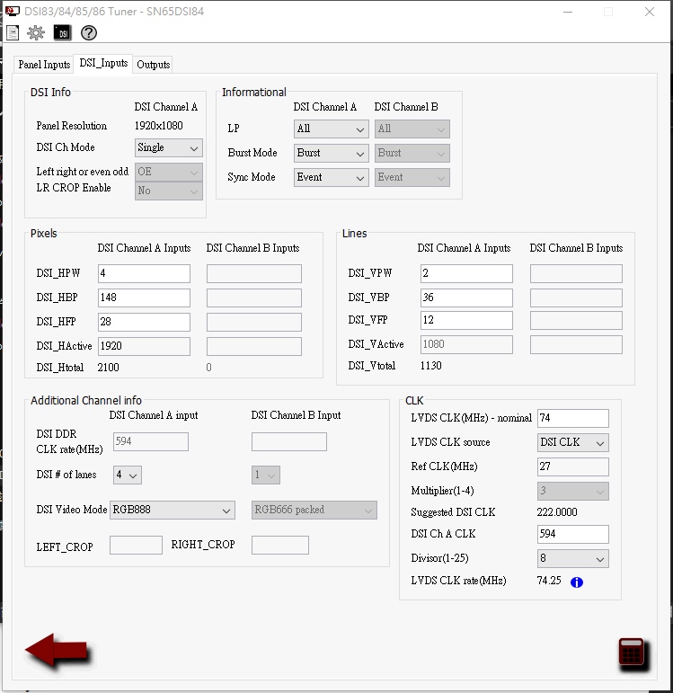

  • Hi Mark,
    Looking at your DSI-Tuner settings, your DSI-CLK is way too fast. Your DSI CLK should be 444 MHz for these settings.
    Please also ensure that you are enabling the PLL in register 0x0D as this needs to be done manually.
    I.K.

    You still need to update the clock settings as mentioned above.
    I.K.
