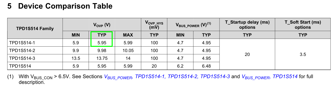

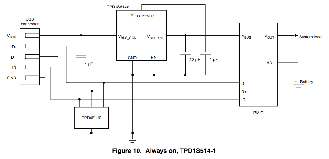

Hi Team,
My customer is using this part(TPD1S514-1) as solution and their system operate in normal USB 5V application,they measured this part and found the OVP point is locked around 5.62~5.74V, which is a bit lower than out spec ,kindly ask is this normal ?
the way they measure the OVP is to provide the voltage on connector VBUS side(VBUS_CON), and when voltage is increase to around 5.62~5.74V , the VBUS_SYS will voltage will started to drop to 0.
