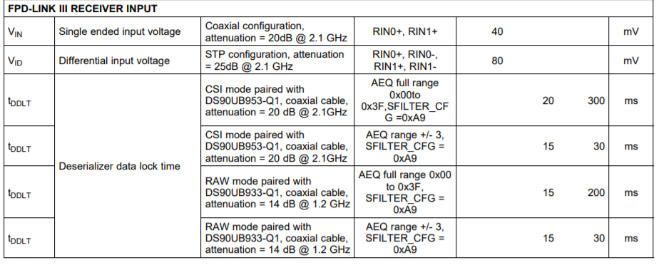

  • Hello Masaru,
    The LOCK time is defined in the 954 datasheet:
    The typical lock time is ~15-20ms when paired with 953. Max lock time is defined by the range of programmed allowable strobe and EQ settings as shown in the table. If you want to reduce maximum lock time, you can program a reduced set of allowable EQ/strobe settings min/max based on the MAP tool results.
    Casey
  • Casey,
    Thanks again for your kind support.
    I understand optimizing the EQ / SP level by MAP helps to reduce Des data Lock time.
    The question on this thread is focusing on Ser Lock time which sequence chart of datasheet shows.
    How should we consider this time to estimate whole system start-up?
    Masaru
  • Hello Masaru,
    We do not specify SER lock time directly in the datasheet, but for this device combo the typical SER lock time from SER PDB = H to SER lock to back channel is ~5ms
    Casey
