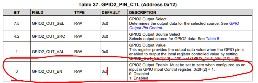

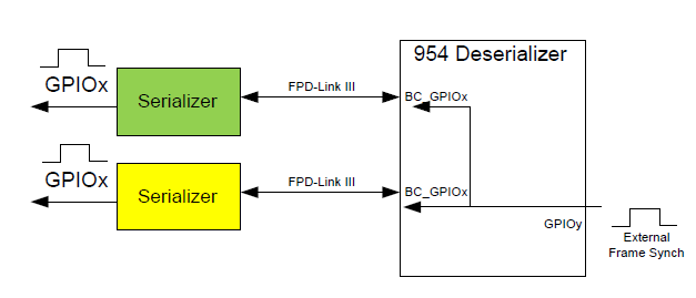

Hi team,
My customer is using the DS90UB954 and DS90UB953 now. We want to use the External FrameSync MODE use the 954 GPIO 0 as the input, 953 side GPIO2 as the ouput. 954 side 0X18:0X80, 0X6F:0X8A, didn't configure 953 side. currently it doesn't work. Do you have some suggestions? Thanks.
