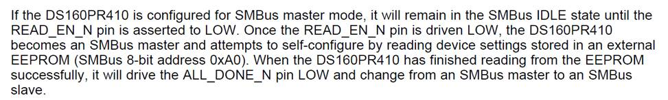

3. as below capture from datasheet, if we set ENSMB=L1 but EEPROM is empty, which means DS160PR410 can't read any data from EEPROM, the ALL_DONE_N pin will keep high or it will remain a while high then go to low and change to SMBus slave mode.
We need your help to clarify the questions to let customer know how to programming DS160PR410 will be the best way for their debugging.

  • Hello Anne,
    1.  If the EEPROM is empty, the DS160PR410 would still attempt to read the data from the EEPROM (after driving the READ_EN_N pin low) and then drive the ALL_DONE_N pin low.
    2.  It is still possible to use BMC to program the DS160PR410 with ENSMB=L1 after it drives the ALL_DONE_N pin low and enters the I2C slave mode.
    3.  See 1 and 2.

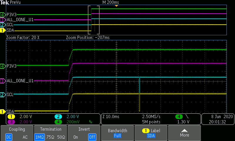

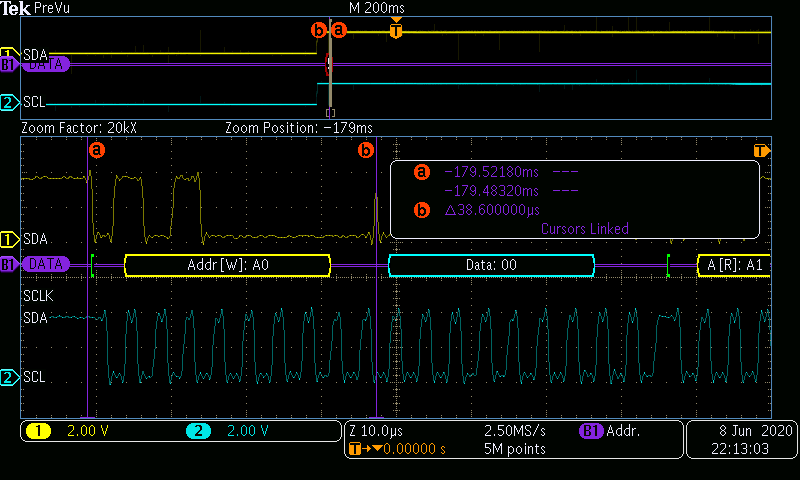

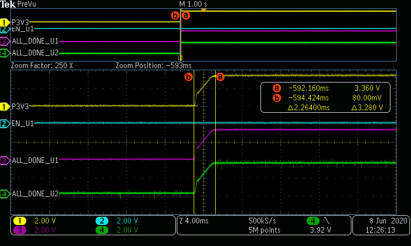

  • Hi Davor,
    Customer has confirmed some items and measured important signal and I2C waveform as follows.
    There are eight DS160PR410 in this design. The READ_EN_N is driven low for the first device. And the EEPROM does have an 8-bit 0xA0 address.
    However, the All_DONE pin isn’t driven low.
    Here are the results of some specific signals.
    (The waveform of the P3V3, EN_U1(1st device, pull down to ground), All_DONE_U1(1st device, connect to second device READ_EN_N), All DONE_U2(2nd device connect to 3rd device READ_EN_N).
    The first command of I2C bus are shown below. (address: 0xA0)
    And the whole I2C waveform decode as attachment.

  • Hi Davor,
    The voltage on the EN_SMB pins are all around 0.9V which means the SMBus of eight device are all in Master mode.
    Attached is the schematic. Please help review our schematic and give us advice.

  • Hello Li-Jyuan,
    The DS160PR410 expects an EEPROM table to be in a specific format (See SNLA320 for more info).  It first looks at the Base Header and if the base header data is unexpected, it will attempt to read it several times until the DS160PR410 EEPROM state machine enters an idle state.
    My assumption was that the ALL_DONE_N pin would go low after entering the EEPROM idle state (I was recently working on a similar device that behaves just like that), however, my assumption was wrong.  The DS160PR410 behaves a little differently.  It enters the EEPROM idle states after several attempts to load from a empty EEPROM device, but its ALL_DONE_N pins never goes low.
    I have confirmed this on the DS160PR410EVM-RSC (8 devices daisy-chained for EEPROM load operation) and the DS160PR410EVM-SMA (a single device).  This was also confirmed in simulation.
    While the device EEPROM is in the idle state, the device can operate normally.
    So, if the plan is to always program the DS160PR410 devices using BMC, ideally you want the DS160PR410 devices to be configured for the i2C Slave Mode.  However, if the DS160PR410 devices are configured for the I2C Master mode, programming them with a BMC is also acceptable.
    Davor

  • Hello Li-Jyuan,
    Yes, while the device EEPROM is in the idle state, the device can operate normally.
    There is an EEPROM_CFG_FAIL signal that affects the state of the ALL_DONE_N pin.  As the device failed to load a correct EEPROM image, it goes into the EEPROM idle state, but does not drive the ALL_DONE_N pin low to indicate the EEPROM image was not loaded.
    If the EEPROM table is wrong or empty, the IC can work normally, but it would have default CTLE settings that may not be optimal for your design. The ALL_DONE_N pin would not go low indicating it failed to load an EEPROM image.
