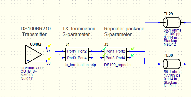

I have received IBIS-AMI model DS100BR210. I can see there are several S parameter files as below.
1. tx_termination.s4p and rx_termination.s4p: Is these S-parameter act as termination for IBIS model?
2. repeater_pkg.s4p: Is this package S-parameter file the same for transmitter and receiver both?
Please see schematic, Have I done modelling correctly?

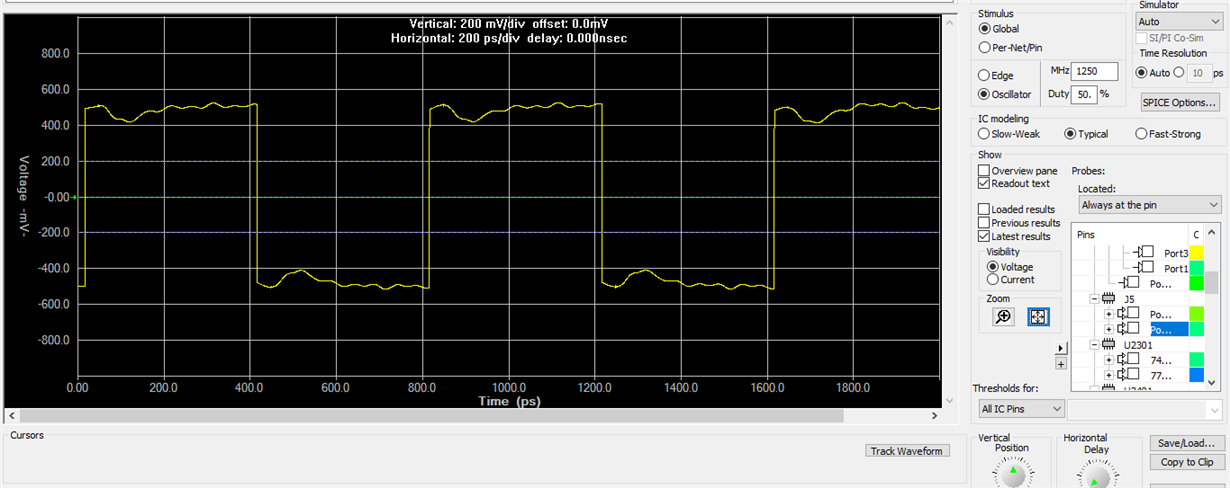

I'm using hyperlinx tool for simulation. Please see the simulation waveform. Rise/fall time is very fast ie. ~1ps. Is this normal?
DS100BR210 Modelling in hyperlynx:
Simulation result: rise/fall time is very fast ~1ps.
