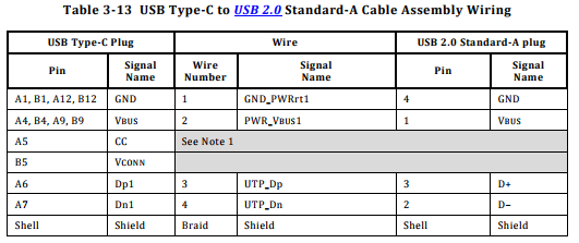

I'm using HD3SS3220 and TS5USBC412 in a project.
I want to use one USB-C port as third functions.
Console & OTG & Host (opposite direction). These are different ports.
An idea is that;
Role of USB-C will be set by the type of connected device.
HD3SS3220 is in DRP mode and provides a proper USB2.0 direction path by CC pins on usb-c connector. Right?
When a laptop or PC connected to usb-c, HD3SS can sense it and will be set as UFP own.
When a peripheral (like a usb flash disk), will be set as DFP own.
There is a bidirectional USB2.0 mux (TS3USB221) at the output of port controller.
USB power provider will be supported by ideal diode ICs against power conflict.
Seems work in principle. Agree?
