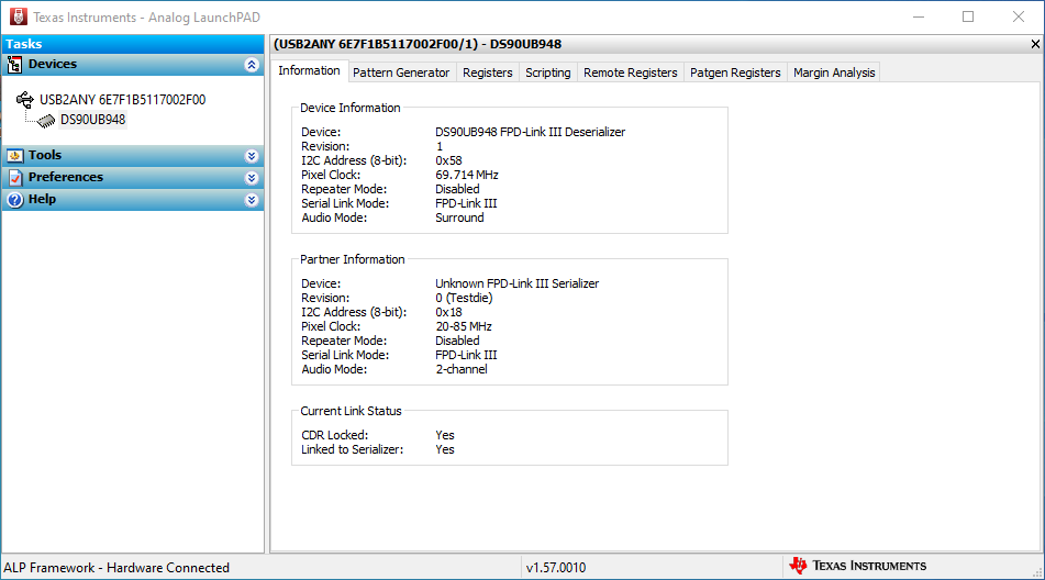

  • Hi Casey,
    The BIST Clock source bits are 00, so that means the BIST clock source should be the external pixel clock, right? In the information tab (under normal operation), the deserializer pixel clock is hovering around 70 MHz while the serializer pixel clock is around 75 MHz, as shown:
    When BIST is enabled, the deserializer information remains the same while the serializer Pixel Clock is listed as "20-85 MHz" as shown:
    Josh

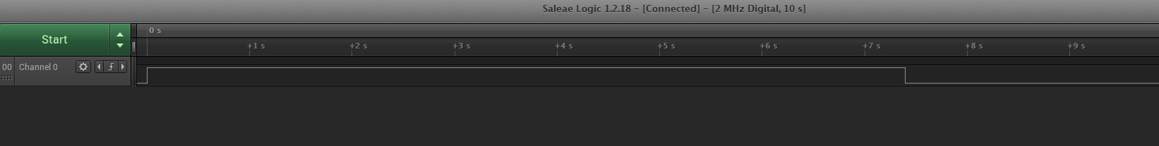

  • Hello Vijay,
    I attached a logic analyzer to the pin and got the following capture:
    The PASS pin appears to go high as soon as BIST_EN is set and goes low only when BIST_EN is cleared.
    There were 4 total CRC errors detected during this test, according to the Back Channel CRC Errors registers in the serializer.
    Josh
  • Josh
      Looks like your fwd channel fpd link data is clean , since PASS was high as BIST_EN is high. Seems like you had some CRC errors but that is on the back-channel.so that does not affect the quality of the video. Here some questions or things to try:

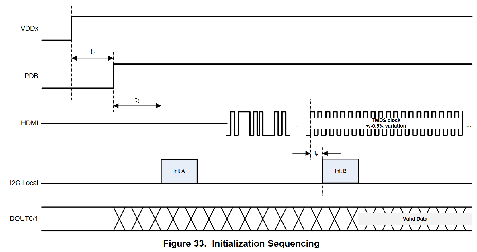

  • Hi Josh,
    I reviewed your posted on 6/5/2020 at 11:47AM when you reiterated the behavior of the issue. The behavior might lead to suspiciously of the device being locked in an unstabled clock. On 949 device, you must performed the initialization A and B locally, and allowing some time of t6 to be stabled before you perform initialization B ensuring you are locking a stable clock. Could you please confirm if this has been done in section 9? Below is the snapshot.
    Aaron

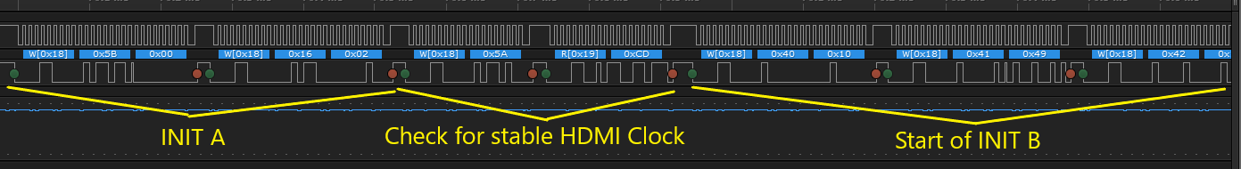

  • Hi Aaron,
    Here are the snips of my initialization sequence:
    First, a zoomed-out view so you can see the power and PDB lines:
    Next, a zoomed-in view of the I2C Initialization:
    I can provide more captures with the rest of INIT B if you want, but it follows the datasheet. I am still seeing the lines appear on the screen despite this process.
    Josh
