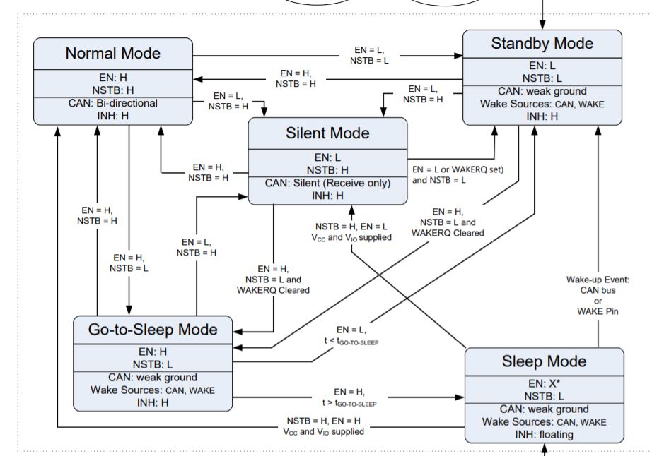

I could find this picture on the CAN Transceiver datasheet, and I wonder the state of EN pin on the sleep mode.
I knew that the only state on EN is High or Low, I could know that EN of the CAN Transceiver is LOW at first and it changes to HIGH when the mode is changed to the Normal.
I could see the state of EN is x, I do not understand the x meaning.

    "X" simply means that the state of the pin is not relevant.  It could be either high or low without any difference in effect in this mode.

    I could see the "CAN:weak ground" on the Standby mode, go to sleep mode, and sleep mode, could you please explain what the weak ground means?
    I could find the INH:floating on the sleep mode on the picture.
    I know that the INH has two state (high, high Impedance), when it is high, output is Vsup-Vfet_diode, when it is high impedance, output is floating.
    Can I think high impedance is INH Low?
    What is the meaning of floating when INH is high impedance?
    Thank you
    INH floating
    "Weak ground" means that CANH and CANL are biased to ground via the input resistances of the receiver; you can reference Figure 20 in the datasheet for an equivalent schematic and some more information.
    "High impedance" on INH means that it acts as an open circuit - i.e., it sources/sinks minimal current.  If you wanted to ensure that this "floating" output results in a low state, you could use a pull-down resistor to connect INH to ground.  A value like 100 kOhm is common and would allow the voltage to be near 0 V when INH is high impedance without sinking much current when INH is pulled up to VSUP.
