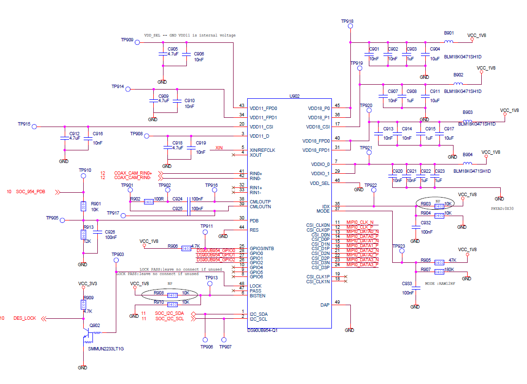

There is a PCBA, DS90UB954 and DS90UB953  can communicate , but SOC does not communicate with DS90UB954,  the system doesn't work .
When I replaced the DS90UB954 on this board with a new DS90UB954, the error disappeared. I replaced  the DS90UB954 on a good board,The good board doesn't work .
What causes this problem,ESD or others , we have four boards with this problem,How should I do
