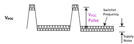

    (3) I saw other requirements from application note as below. What's difference between below requirement and  VPOC <10mV requirement?
    Vpoc supply noise ≤ 100mVpp
    Vpoc pulse ≤ 500mVpp @ camera frame rate frequency
    Vpoc pulse slew rate ≥ 100 us/V
    BR
    Paddy
  • Hi Paddy,
    (1) Are you able to clarify this question for me?  Also what figure are you referring to in the datasheet? I see figure 36 is referring to the I2C bus.
    (2) Is this the requirement on the side of the deserializer which is different the the requirement on the serializer side of the link which is addressed below.
    (3) Below is a image showing a typical PoC voltage and noise.  Vpoc supply noise refers to the noise introduced from the supply.  Vpoc pulse refers to the transient introduced from the sensor's change in current draw during capture valid frame data and blanking periods.  The slew rate refers to the length of time it takes for the voltage to change.
