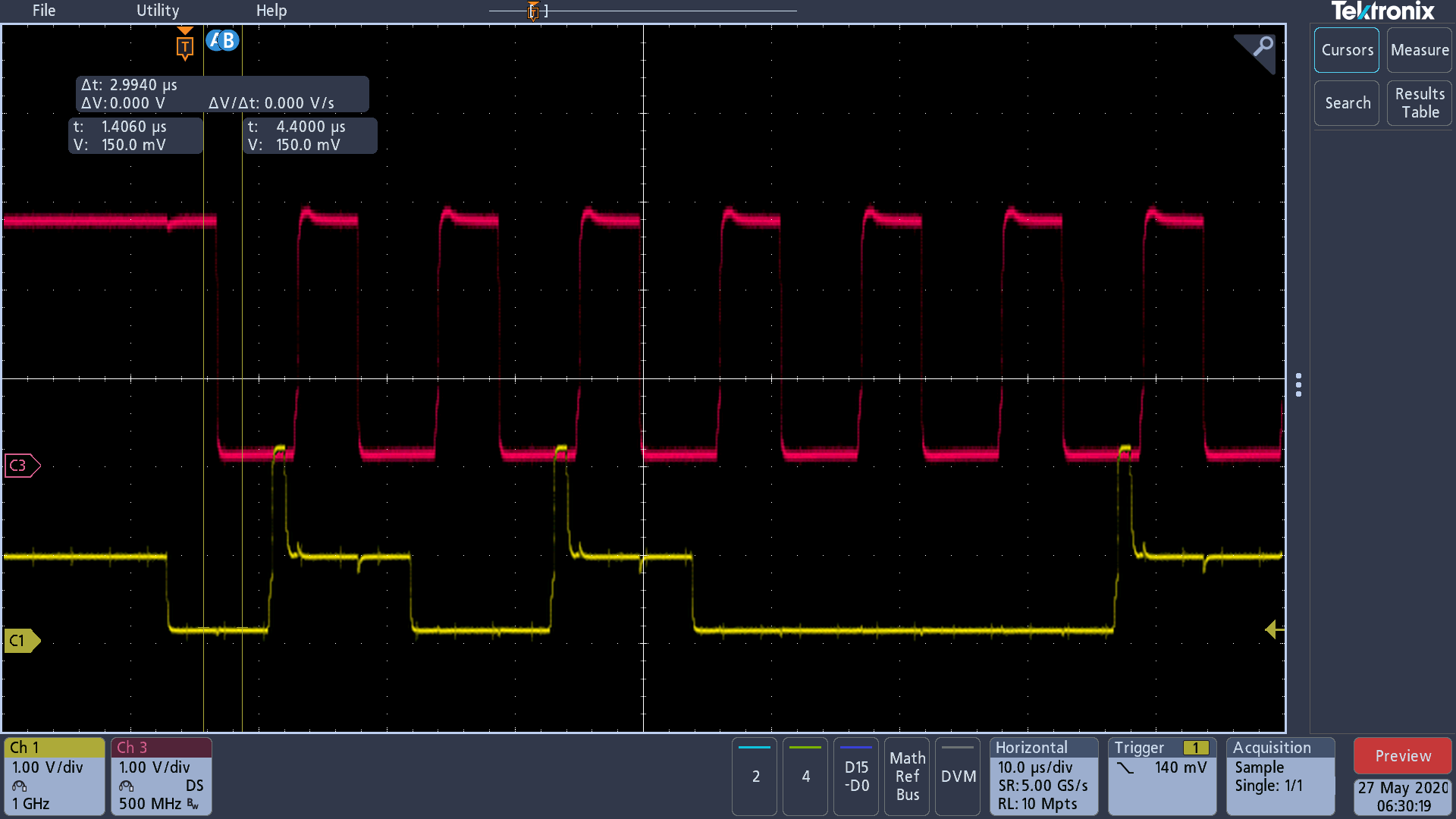

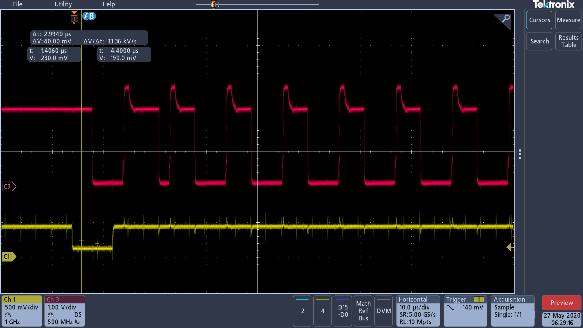

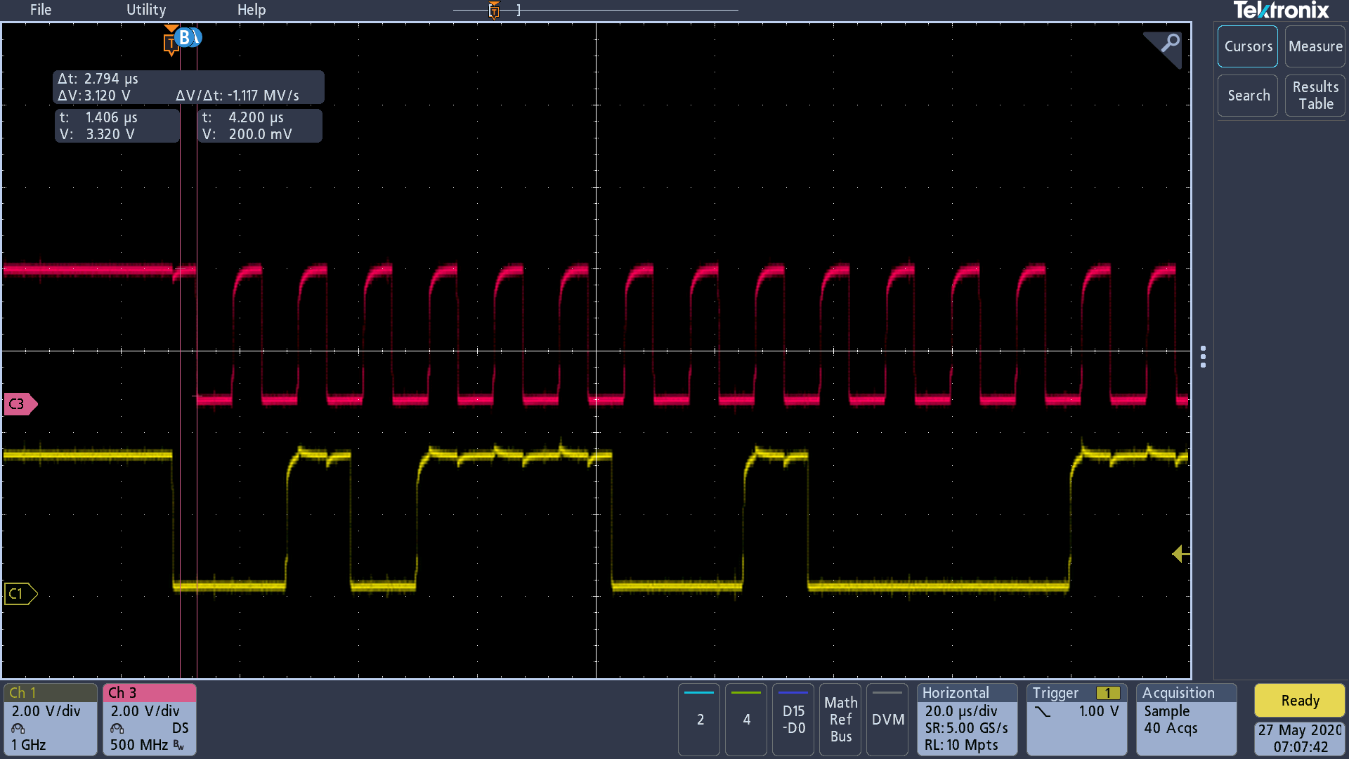

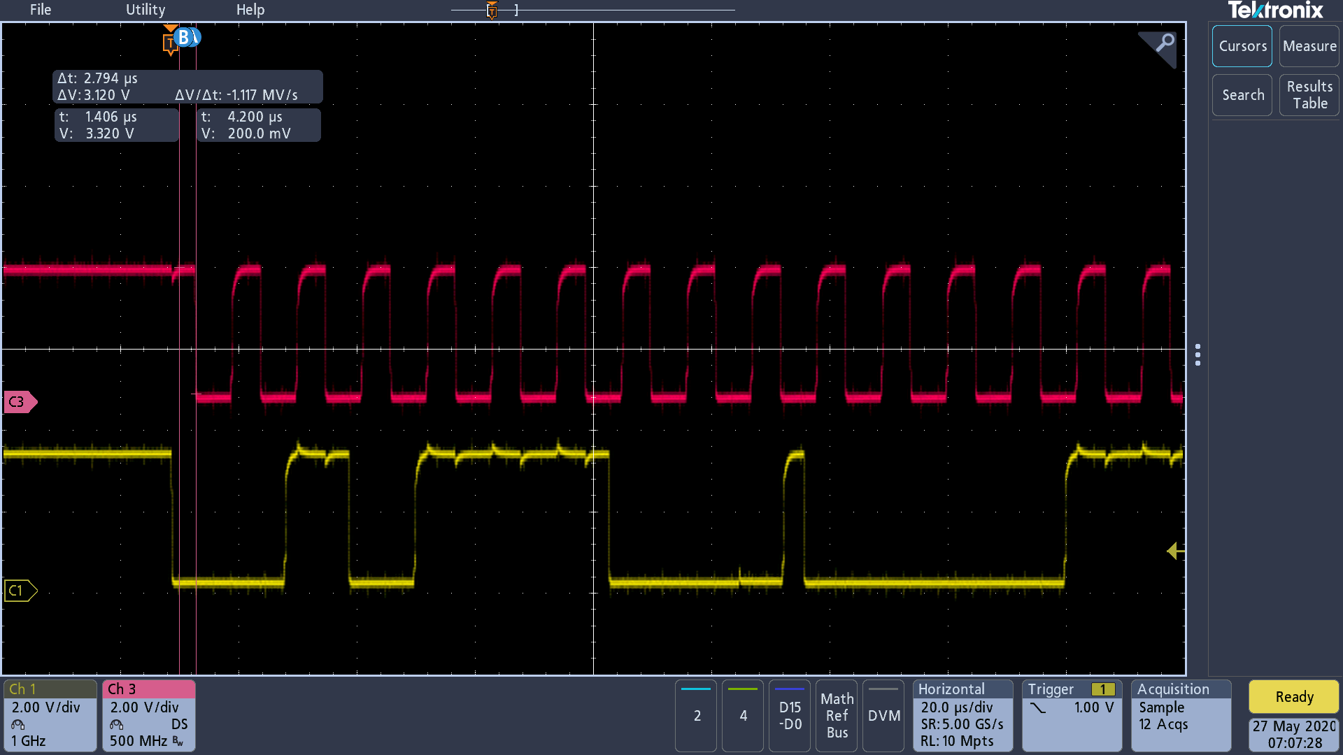

    I have attached the following images:
    Tek00000 – failed chip unplugged
    Tek00001 – failed chip plugged in
    Tek00004 – working chip plugged in
    Tek00005 – working chip unplugged

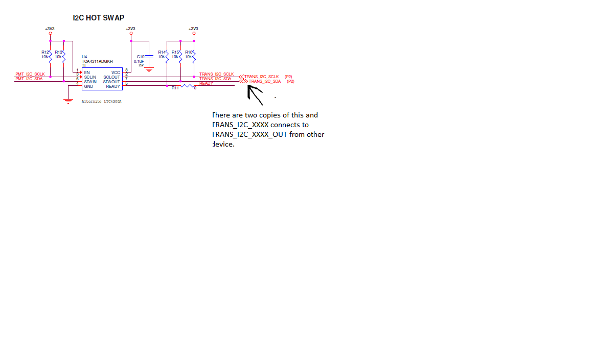

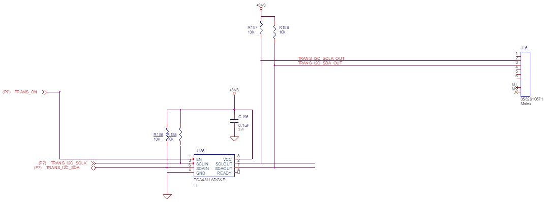

    SCH1.png - TCA4311A on Master side.
    SCH2.png - One copy of TCA4311A connected to Master by cable.

    ^^From this waveform, it looks like the clock line has some kind of impedance divder which causes the idle voltage to rest below 3.3V. The spikes on the rising edge show that the rise time accelerator of this 4311A is working/not damaged on the clock. The data line looks like theres also a larger impedance divider which causes the signal to never rise above ~500mV so the rise time accelerator on this side likely doesn't activate.
    ^^With the device plugged it, the dataline looks like it is capable of triggering one of the rise time accelerators, this is likely due to the pull up resistors being in parallel allowing for a larger current (generating a higher idle voltage). The idle voltage on the clock line looks like its shifted up higher as well due to the additional current from the other pull up resistors so the spikes from the rise time accelerators are less noticeable.
    From the waveforms of the working boards, I don't see any undershoots that I was initially worried about so the damage likely isn't caused from the parasitic inductance. The schematic you provided looks okay to me as well.
