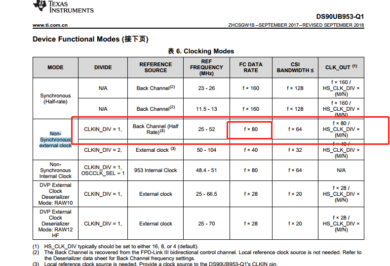

customer use DS90UB954 /DS90UB953 in 4MP camera porject. the register setting is the same with DS90UB935 / DS90UB936. because brefore they use DS90UB935 /DS90UB936 in mass production project.

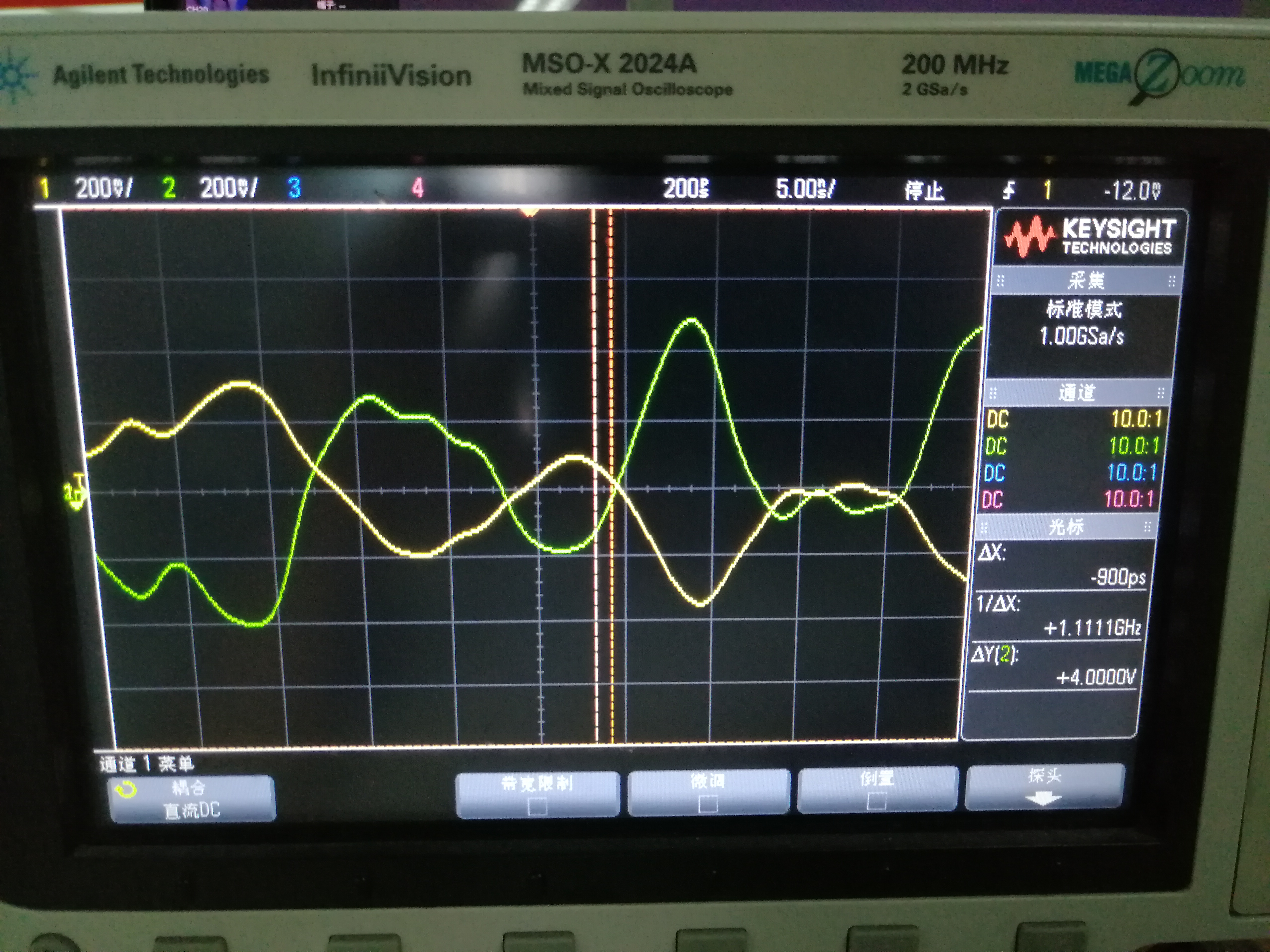

the prolem is there have data on CSI pin of DS90UB954,but the data is wrong and can't display normaly.
could you provide the DS90UB954 /DS90UB953 reference register settings?
customer sensor is IMX335  4-Lane 10bit ;4MP/30fps ; MIPI speedrate 594Mbps/lane. below is customer register setting:

Adaptive Equalizer to complete adaption.
Ds90ub953寄存器配置
MODENon Synchronous external clock
Address
Data
备注
0x01
0x03
Reset
0x06
0x4F
Sensor时钟配置,接近37.125Mhz
