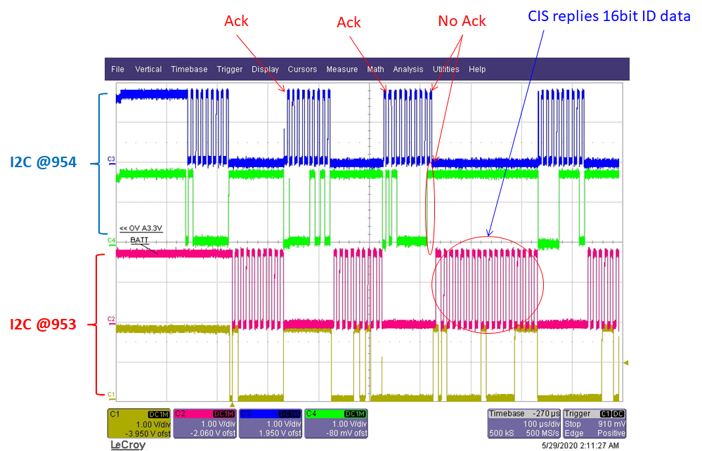

  • Hi Casey,
    Some I2C communication problem found at 953.
    1. It's looks like a clock stretch problem.
    2. RnD said the sensor ID is 16bits format, and SOC will judge whether it get the correct sensor ID. If the ID correct, the following sensor initialization will no problem. Otherwise, the sensor initial will failed.
    From the this I2C communication, does 953 can accept 16bits read data and send to 954 with no problem?
    Alex
  • Alex,
    I'm not sure what you are trying to show with the above picture. 954 and 953 can support 16 bit addressing without any issue and also I2C clock stretching is normal/expected when communicating across the control channel like this
    Can the customer confirm the sensor configuration by reading back all the programmed registers to confirm that they were programmed correctly? Does the I2C master support I2C clock stretching?
