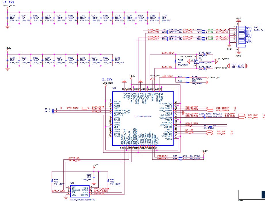

Could you help me review TUSB9261 schematic? Thanks!
Hi Jimmy,
Could you give more description on the use case for this schematic? From the schematic it seems that the USB may be connected as a downstream port, TUSB9261 USB port is only meant to be a upstream port. In other words TUSB9261 only work as USB to SATA not SATA to USB.
