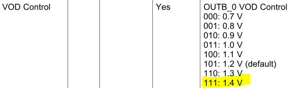

  3. My customer use different VOD Control register settings in gen-3 mode, while the test results are different. VOD control=111b has better eye opening than other settings. What may cause it?
    Answer: The maximum VOD control setting will tend to produce the largest vertical eye opening and results in the most linear response.  For many PCIe applications using the higher VOD control settings with the DS80PCI800 produces the best result.

  • Hi Miranda,
    For the DS80PCI800 in non-limiting mode the VOD setting bounds the maximum output amplitude.  The output amplitude can go as low as 0V differential if there is no signal on the input.  Once there is a valid input signal, the output amplitude is typically equal to 1.25x the input amplitude.  Once the output amplitude has reached the VOD setting value (for example 1200mV) the output amplitude will no longer increase with respect to any further input amplitude increases.
