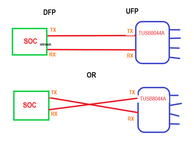

My customer would like to confirm TUSB8044A and their SOC signal connection, which one is correct?
Do TX & RX connect direct between SOC and TUSB8044A? Or TX & RX signal should be swap?

Hi Paul,
The second image connection is correct SOC TX should be connected to Hub RX and vice versa. Please see the document below to help with creating the schematic.
https://www.ti.com/lit/an/slla447/slla447.pdf?ts=1591014810482
