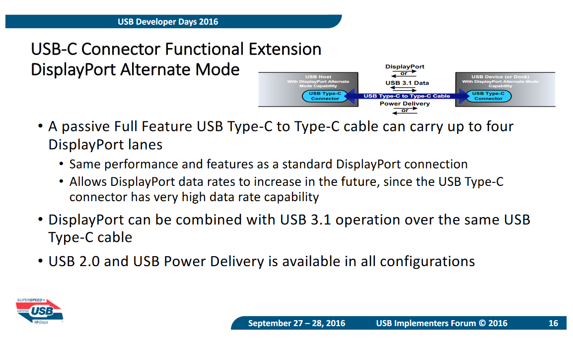

Hello, i have a question about USB 2.0 lines in DisplayPort mode. While we are not in DisplayPort mode we have and can use USB 2.0 lines, but when we enter in DP mode, they are gone and don't show up.
Is there a reason for this? Does this work as expected or am i missing something? I dont see a reason for USB 2.0 not working while in DisplayPort mode.
Any help is appreciated.
