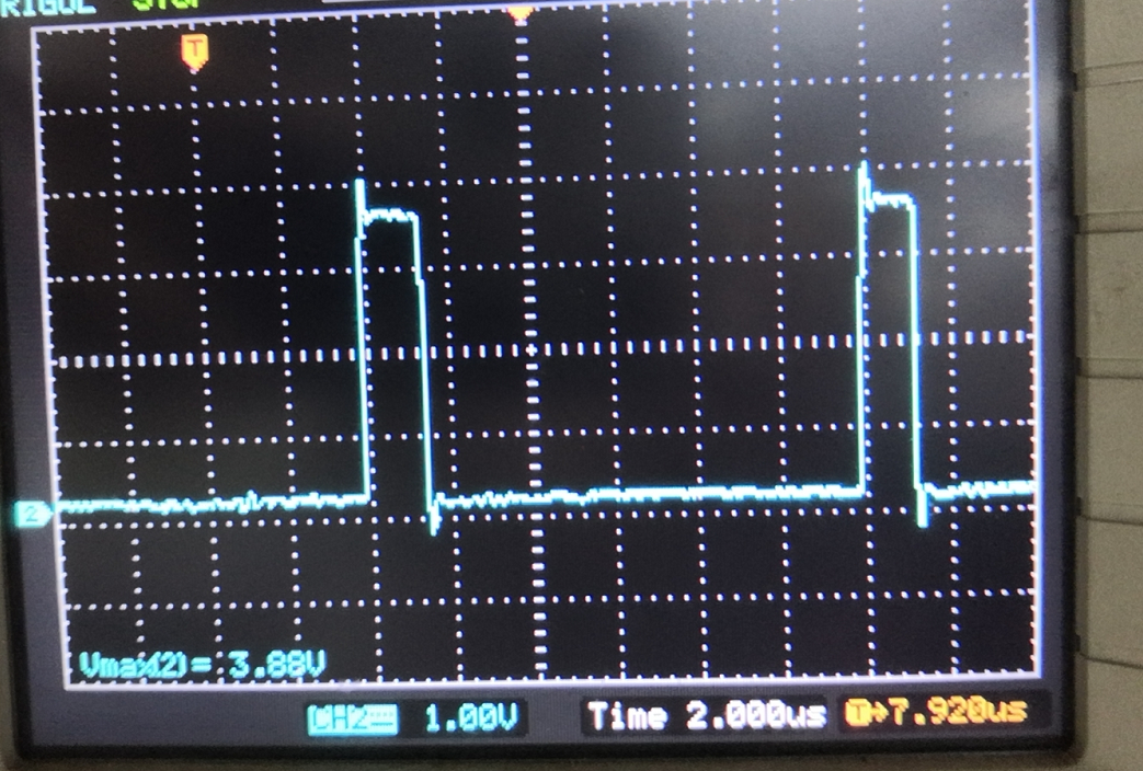

My customer now use I2S in 921 to pass through data.
It could pass through but the frequency is not correctly.
When input 4MHz PWM in 921, it could only output 200kHz PWM in 948.
The waveform are as following:
4MHz in 921:
70k in 948:
I saw the GPIO Brf=0.25*f and Brb=40kHz. But datasheet haven't mentioned about GPIO_REG.
May I ask what the max data rate in GPIO_REG?
  • Hello Amelie,
    What signal is being shown here? I2S_CLK, I2S_WC, or I2S_DA? What is the PCLK rate being used as the input to the 921 during this test? Also are you using I2S forward channel frame mode or data island mode? Also why is the signal so distorted? It would be strongly suggested to improve the input signal quality
    GPIO_REG are GPIOs controlled by register so this is not applicable for the I2S rate. The I2S signals must be < 1/4 of the PCLK rate
