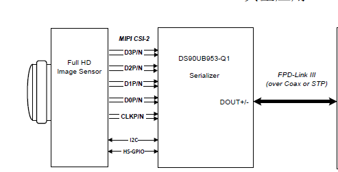

Part Number: DS90UB953A-Q1
dear
4pcs 953 connect 1pcs 962 show as below,Is there any register configuration code?

Raymond,
please check page22 of UB96x EVM user guide, here it has one script for your reference.
https://www.ti.com/lit/ug/snlu226a/snlu226a.pdf?ts=1591073791939
