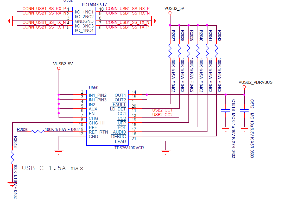

Can you help me to double-check the design?
The engineer would like to use this for CC detect and transfer USB3.1 A type to C type.

Hello Kevin,
I cannot see the capacitance connected to the VUSB2_5V, so make sure that the customer is using a capacitance greater than 120uF for this node. The rest of the design looks correct.
