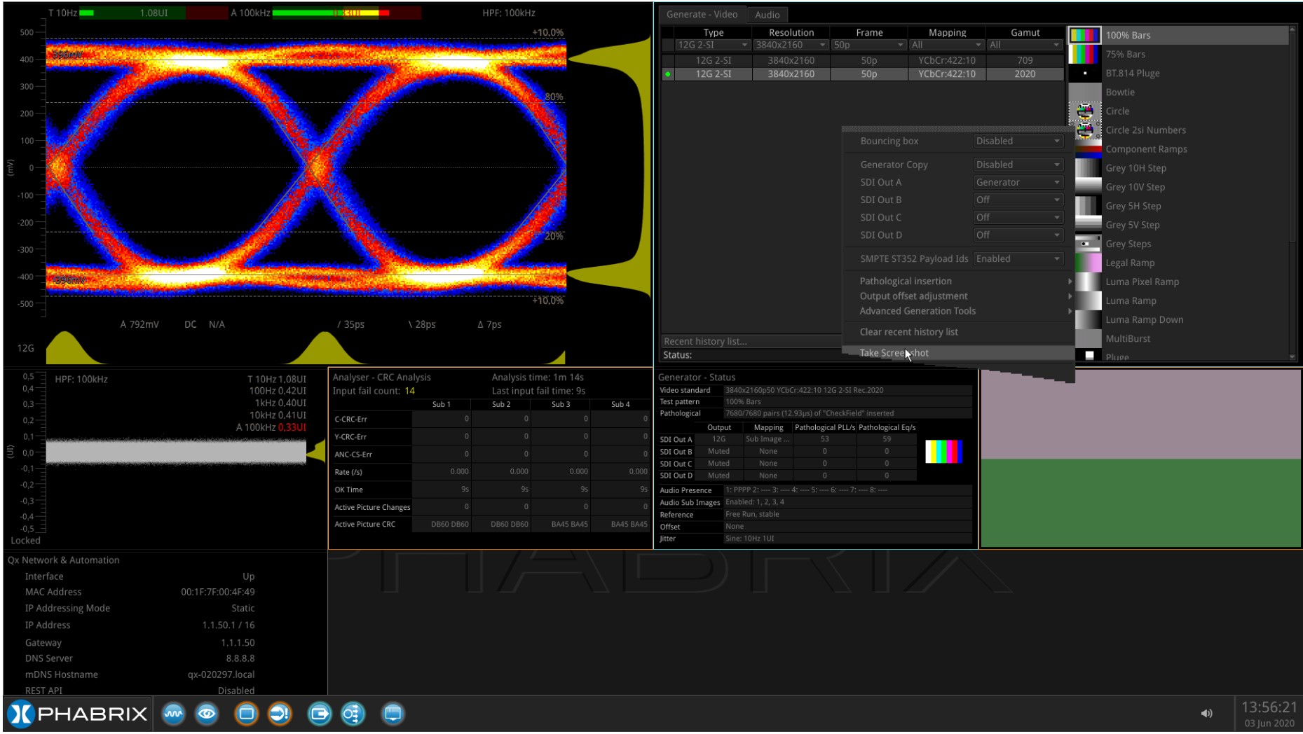

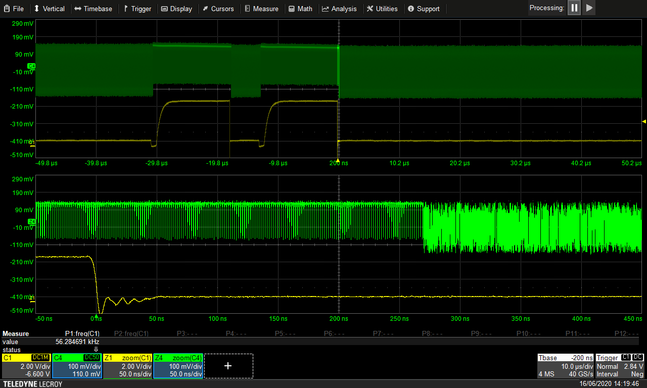

Dear e2e support,
My customer is facing some errors and signal loss when 12G pathological signals are used with our LMH1297 (prototype board or EVM).
The signal is generated by a Phabrix QX. They use 1m cables from Belden (1694A) and HUBER+SUHNER Coaxial Cable Connector (11_BNC-75-5-20/133_N).
Below are his screen shots.
Would you have any idea where the issue comes from?

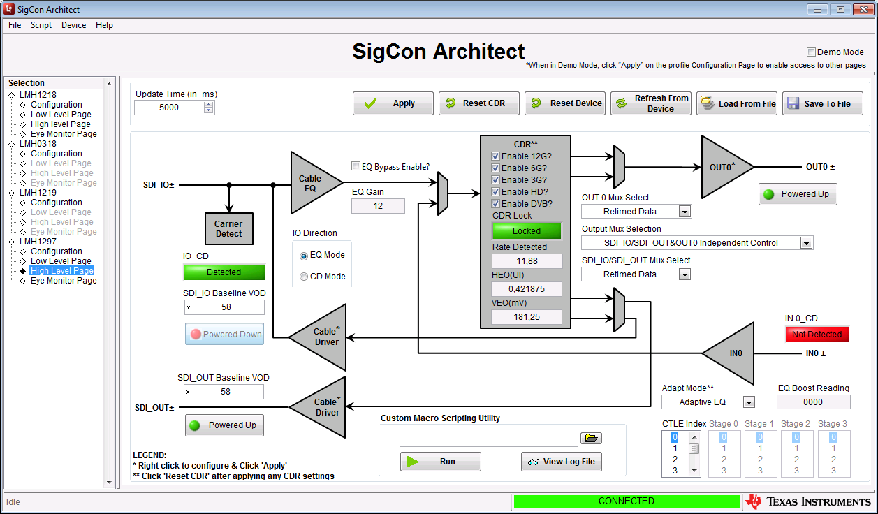

    Please ask your customer to change SigconArchitect Output Mux Selection drop down menue - note middle right hand side of the SigconArchitect GUI image -  to independent control like what i have shown below. This is just to make sure retimed signal is being routed to the 100-ohm output. Do we still observe bit error?
    Also, through TI internal email please send me your customer schematic.
    Regards,, Nasser

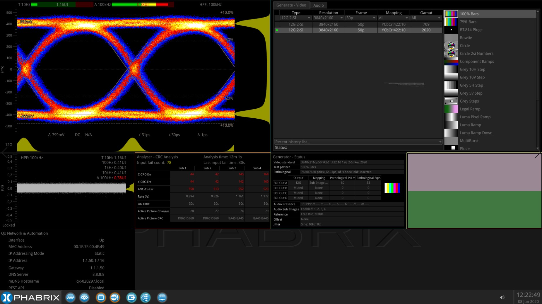

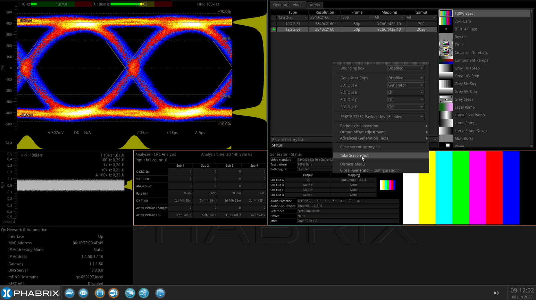

  • Hi Nasser,
    With a normal pattern the LMH1297 has been working properly all the weekend (52 hours) without errors or signal loss.
    With exactly the same configuration and a pathological pattern there are about many signal losses and errors per minute.
  • Hi TISL,
    1). Through internal TI email, please send me your customer schematic.
    2). On OUT0 please make sure de-emphasis is disabled. Sometimes this may cause over-equalization on the receiver.
    3). Please make sure on the receiver we have minimum or no equalization.
    4). Under this condition, when we are receiving error due to the pathological pattern, please send me LMH1297 register contents.
    Regards,, Nasser

    The results are the same. The cable length is 60 m.
    This behavior only happens with pathological patterns.

    Attached is the register settings.
    lmh1297_config_3.cfg
  • Hi TISL,
    I believe customer is right. The issue is related to the pathological low frequency energy content. Pathological pattern has a much wider bandwidth versus color bar for example. Additionally there is DC wander - unlike color bar - and device has to track this DC wander.
    If you like, you can send me your customer LMH1297 evaluation board and i can check in the lab.
    Also, I checked the attached register setting above. It seems signal or cable is not attached to the device. I say this since ConfigIO register 0x25 - cable length indicator - shows 0x00. Also, ConfigIO register 0x02 shows loss of signal.

    Bellow, the customer made two more measurements with the 1297 EVM, 60 m of cable and pathological signals.
    The difference between the two measurements is the polarity of the pathological pattern, in one case the pathological pattern is composed of nineteen 0s and one 1 and in the other case of nineteen 1s and one 0.
    The oscilloscope screenshots are taken triggering with the Phabrix GPO that indicates the pathological pattern on the 12G signal.
    The yellow trace is the GPO and the green trace is the data signal. You can see appreciate the pathological pattern with different polarities in the two figures.
    When the nineteen 0s and one 1 pathological pattern is generated, the LMH1297 the jitter is 0.35 UI and the Phabrix does not report signal losses as you can see in one of the Phabrix's screenshots.
    In the case of the nineteen 1s and one 0 the jitter is 0.42 UI and the Phabrix is continuously losing the signal as you can also see in the other Phabrix's screenshots.
    In both cases the jitter figure is over the 0.3 UI that the SMPTE ST 2082-1 requires.
