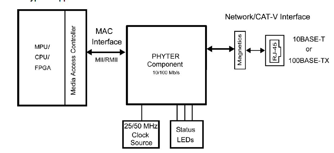

Dear E2E,
Please provide the routing impedance for MAC interface side and Network/CAT-V interface.
Hi Ramya,
The MDI Network/CAT-V differential pairs should be routed with 100-ohm differential impedence.
The MAC interface pins should be routed with 68-ohm impedence.
I'm happy to share the Design and Layout guide that will provide our guidelines in designing our Ethernet PHYs:
http://www.ti.com/lit/an/snla079d/snla079d.pdf
