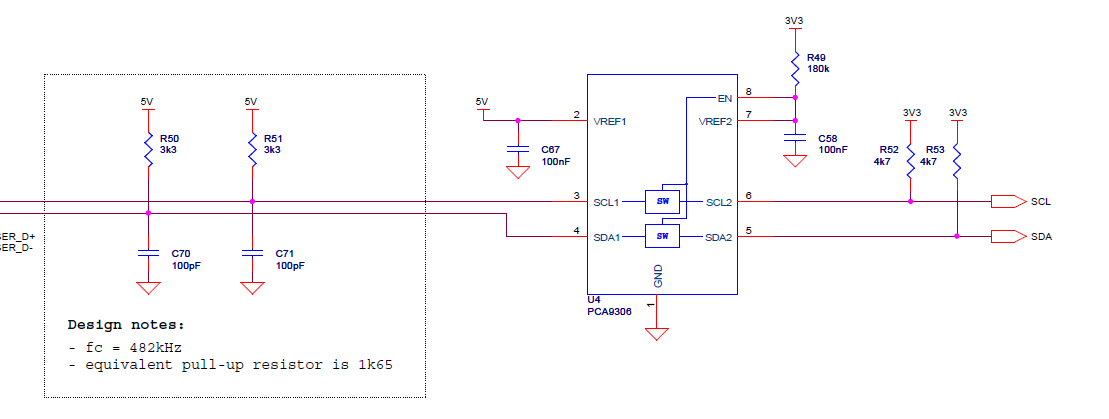

I'm facing an issue with the PCA9306 on some products.
One eight board I investigated, I found the PCA9306 with a low impedance between clock and data input/output.
It read the datasheet many times and I thought there is a problem with our schematics:
We use it in that way:
And it seems it will be preferable to use it with the 5V on VREF2 to respect the datasheet statement saying that VREF1 must not be higher than VREF2.
I'm I right ?
What is the exact consequences with our design ? It seems it works on many products a long time (product sold since 4 years now)...
Thanks in advance for your lights.

    [Bobby] The consequence would be that the 'ViL' for the device is now lower. So essentially you've done 2 things, (1) slow down your prop delay and (2) gave yourself a lower ViL. {I use ViL loosely here as this is not the real name for the parameter, what I mean is side x will follow side y once it is below 'ViL'}
    In actuality, this lower ViL you have has very little effect on the signal integrity. Prop delays elongation is likely in the double digit nanosecond range and since you aren't operating at a super low Vcc level like 1.8V or lower the foot room you have for ViL should be more than enough.
    Getting to the point here, swapping the higher voltage rail for the lower voltage rail on Vref1 and Vref2 should NOT result in damage to the device and only generates mild differences in operation that shouldn't matter at ~482kHz operating frequency.
    From what I can see, there shouldn't be damage occurring to the PCA9306 device based on the schematic. The device itself is actually pretty robust compared to most I2C devices when we look at the absolute max IoL it can handle (128mA) so I rarely see this device get damaged from an over current event.
    May I ask what is connected to both sides of the PCA9306? (any I2C buffers? Cabling? Anything that someone could touch and zap with ESD?)
    -Bobby

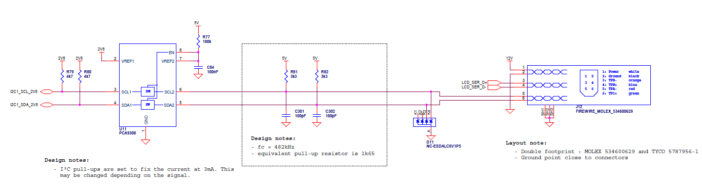

  • Hello Bobby and thanks for your help.
    So I understand in your explenations that swapping our voltage rails will not really improving the robustess of the PCA.
    But It will improve the low voltage level and the propagation delay.
    On the 5V side, there is a FireWire cable of 1 meter which is connected to another board containing an another PCA9306 (I joined schematics).
    On the 3.3V, we have I2C components as bus extender, touch screen driver, LED driver.
    You advise to re-inforced ESD protections on our schematic ?
  • Sorry I made a mistake in the pictures posted. Below you see the intire schematic of my first post:
    [Bobby] So the 1 meter cable may potentially be a source for something called inductive kickback which I have seen damage our devices before. Can you get scope shots of the communication on the cable sides with the cable connected and communicating? We would want to see from the master cable side and receiver cable side for any undershooting.

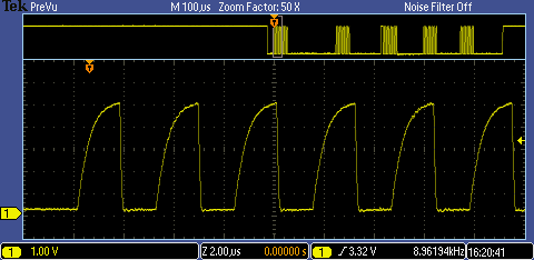

  • Hello Bobby,
    Below you can see scope trace for SDA slave side:
    SCK slave side:
    SCK master side:
    SDA master side:
    Thanks.

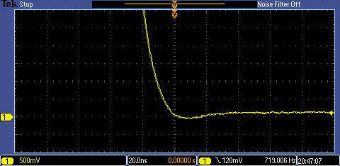

  • "Adding resistors should be enough in order to protect the I2C lines (assuming there are ESD diodes between SDA/SDC signal and the Vref rail inside the components ?)"
    Correct. we do have ESD cells on our Vref/SDA/SCL lines. Our datasheet seems to spec that if you go below the absolute max ratings and conduct one of the clamping diodes (from the ESD cell), you should limit the current to less than 50mA.
    The SDA Master waveform on the falling edge seens to take some dips slightly below GND. Can you redo all the waveform shots and zoom in one on falling transaction with very high resolution and sampling? We want to see if the signal may be undershooting too far. I imagine this could damage the device in a way that does not damage the actual pass FETs....
    -Bobby

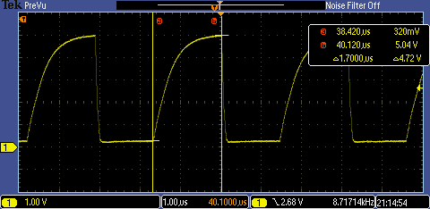

  • Hello Bobby,
    Thanks again for your help.
    Correct for the undershoot on SDA.
    I take new scope traces below.
    SDA master side:
    SDA slave side:
    SCK slave side:
    SCK master side:
    It seems we don't reach the negative clamping voltage of -1,2V, but I'm not really fond of this ring effect.
    In the same way as overshoot, adding resistor can protect the device in the case we go below -Vclamp, right ?
    Have a good day.
  • It looks like the datasheet's absolute maximum ratings for the I/O pins (meaning the SDA/SCL lines) is down to -0.5V. This undershooting could damage the device seeing as it looks fairly close to the limit here.
    "In the same way as overshoot, adding resistor can protect the device in the case we go below -Vclamp, right ?"
    Correct, by adding a small dampening resistor,  infront of whatever is driving this line low we can slow down the di/dt and limit the undershooting effect. Adding some cap could also help but since I2C limits the max cap value this should probably be avoided. I would try adding a 20 ohm series resistor infront of the driver who is pulling low on the SDA_master scope shot. If you have control of the pull down strength of the master, you could also make it weaker.
    -Bobby
