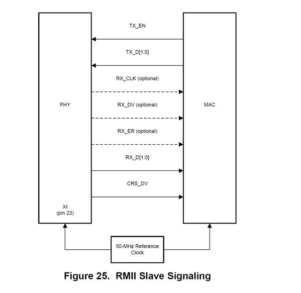

Part Number: DP83822I
Hi
in RMII mode, does customer need to connect pin8(INT/PWDN_N), pin19(MDIO) and pin20(MDC) to MAC?
thanks.

Hi Max,
You are correct, RX_CLK, RX_DV, and RX_ER are optional.
RX_DV and CRS are necessary signals used in MII whereas RX_DV is optional in RMII. You may review these signals in the IEEE spec.
