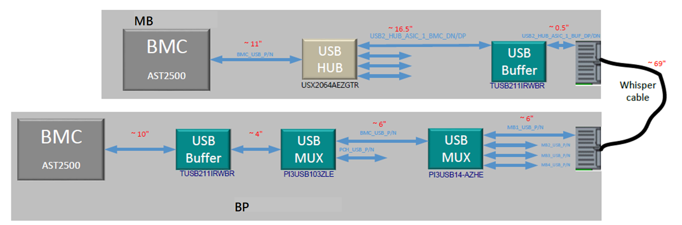

We have tried the EQ setting[MB R5238 to 3.9K ohm to GND and change BP R4451 = 100 ohm to GND], but it doesn’t help(as fig-1).
We have also checked the eye-diagram in Location1 and Location2. (with and without re-driver, we pull down pin-5(RSTN) to GND to disable re-driver)
Strangely, there is no much difference in eye-diagram no matter with or without re-driver as attached(pw:123).
Does it mean the re-driver doesn’t work in the MB?
Could you let us know the TUSB211 EQ strategy(ex. much many dB for leve0, 1, 2, 3)?
And, do you have any idea to improve the eye-diagram result?

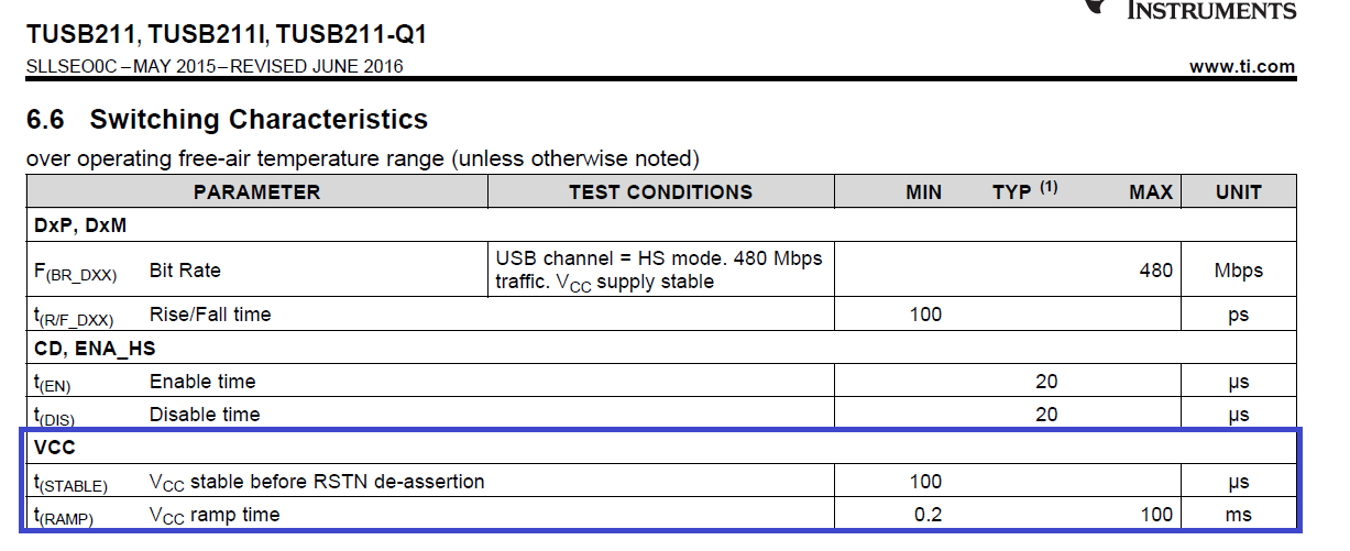

    2. Is there power-on sequence requirement except 6.6 in spec?
    Thanks.

    3.3V power and RSTN seuqence as fig-3.

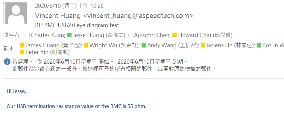

    BMC(AST2500A2) confirms their internal termination is 55-ohm(fixed).
    Is it ok to enable TUSB211 to the high-speed mode and get the signal compensation? or it has a risk that can't enable TUSB211 to high-speed mode?

    BMC termination is high, based on USB 2.0 spec. higher termination mean that TUSB211 boost should minimized, as long as signal quality meets eye diagram, as to avoid the HS disconnect threshold is violated.

    Consider USB2.0 is a dual-way communication, could you base on our topology(TUSB211 locations) to suggest EQ setting for fist TUSB211 and second TUSB211?
    We want to make sure both "Hub to device" and "device to Hub" eye-diagram quality.
    Thanks.
    Andy

  • Hi Andy,
    Tuning of each TUSB211 settings will be necessary to ensure proper signal quality. MB TUSB211 could start with Level 1 AC boost and BP TUSB211 could use Level 2 AC boost. I would also consider TUSB212 for added DC boost functionality, good for long cable and multiple muxes scenarios.
