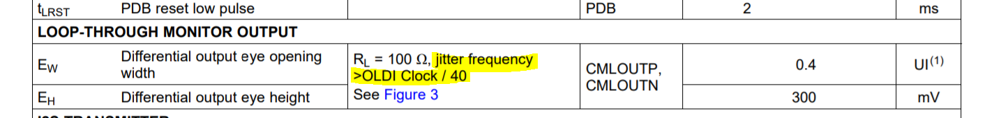

Hi Expert,
For the spec of eye diagram, could you pls help explain "jitter frequency >OLDI Clock/40"? What does this mean, and how to see if this condition is meet or not?
BRs,
Wilson

Hi Wilson,
This can be done with CDR settings and PLL settings on oscilloscope.
I will provide some documents to you via email.

Hello Wilson
You will need Tektronix DPOJET software for this. Can you please confirm you have access to this equipment. If you do you should see the following on the scope
Please let us know if you have this and we can send you step by step guide. If you dont have this and have a different equipment then we need to find a different way to get this data
