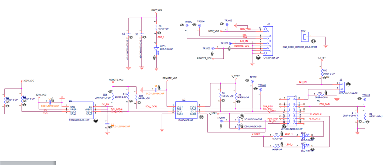

Dear Team,
Below is my customer's schematic design with PCA9306 and ISO1540.
Under some conditions, 3D3V_VCC, SDA and SCL would become floating when there is no connection at J2. But the enable pin of PCA9306 still has power(Remote_VCC). V_STBY has power also.
They would like to know is it possible SDA and SCL of J1 would have noise or drive to low?
Thank you.
Jim
  • Hey Jim,
    The ISO device may be able to drive side 1 of PCA9306 low but since the PCA9306 is a pass FET device, if side 1 starts to dip lower than REMOTE_CC-Vth, side 1 may leak current into side to to push it back up a little. I don't think side 1 floating would drive side 2 low  and in return drive the ISO device low. Worse case is the bus may hang around REMOTE_VCC-0.6V if side 1 remains 'leaking'
    -Bobby
