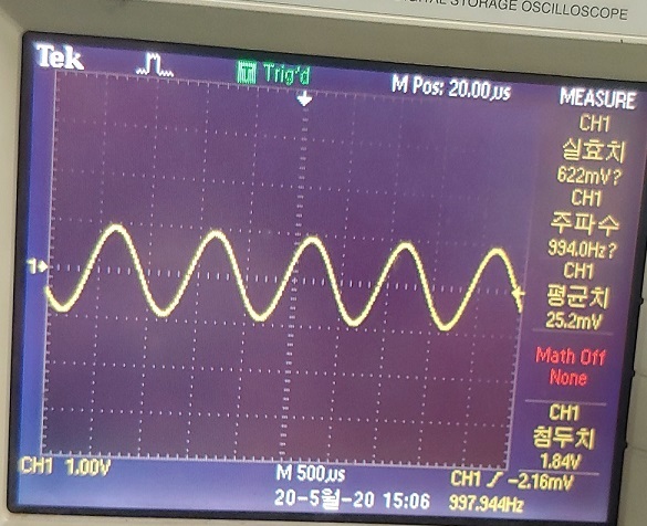

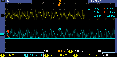

  • Dear Andy,
    The Issue parts is D11,D12,D13,D14,D17,D18, D19,D20. Those are apply for Audio Inputs & outputs.
    I attached about waveform of Audio Input & output for voltage range.
    AUDIO INPUT
    AUDIO OUT
    Thank you.
    Inho Jeon

  • Hi Inho,
    The TPD1E10B09 is a bi-directional device which means that either pin can be connected to the signal line as long as the other pin gets connected to ground. There's no reason for the TPD1E10B09 to be lowering the signals voltage unless for some reason the device is ON, meaning that the voltage differential between PIN 1 and PIN2 exceeds the breakdown voltage of the device. The voltage of the signal lines seem to be +/- 500mV which are well within the working voltage of the TPD1E10B09.
    Is the scope shot you shared, +/- 500mV signal, from the voltage before or after the TPD1E10B09 was applied?
    If the scope shot is the voltage after the TPD1E10B09 was applied, what is the voltage the audio signals should be working on?
    If the scope shot is the actual voltage of the signal lines then the issue is more than likely something else in the system.
    I also noticed you have multiple grounds in the system. Would you also be able to confirm the voltage differential between the audio signal lines and DGND which is the ground that the ESD devices are connected to? Does the voltage differential exceed the breakdown voltage of the TPD1E10B09?
