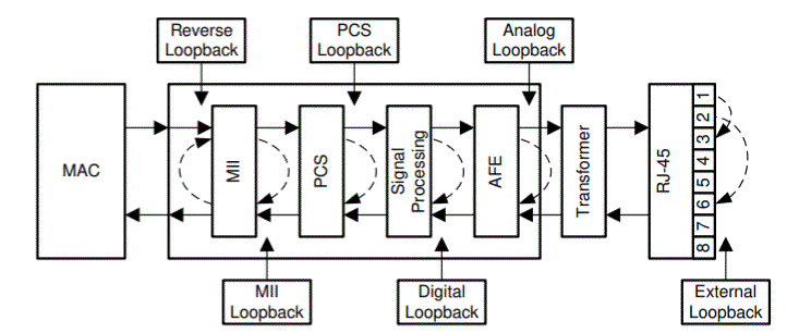

    You should not expect to see data lines on reverse loopback since the loopback occurs on the the cable side. Here is a useful diagram that may help you understand the different loopacks.
    In terms of operation of the PHY, you can look at register 0x1 to review the status of the PHY and determine if there is a link on the device.

    PCS Loopback is enabled by setting bits[6:2] = 0b0001 in the BISTCR Register 0x0016 – BIST Control Register.
    You can check if PCS loopback is working by probing your MAC receive and transmit data lines. But if you are looking at just confirming link up status, you may also read register 0x1.
