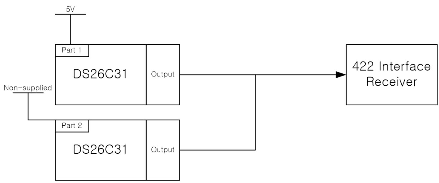

As seen in the related question, I configured the redundancy structure using 2ea DS26C31MQML.
When the primary channel driver is working, VCC power is not applied to the secondary channel.
Usually, the 422 communication is operated using the primary channel, and when there is a problem with 422 communication, are changed to the secondary channel. This means that the VCC of the primary channel is cut off and VCC is supplied to the secondary channel.
My question is:
If part failure occurs in the primary channel, how does it affect communication using the secondary channel?
I am curious about the typical part failure mode. Could you tell me the type of failure mode for this part?
I am concerned that the output pin is shorted to GND, internally.
If the part's output of the channel in use is shorted to GND internally, I think that both the primary and secondary channels cannot be operated for 422 communication even if it be changed to other channel.

    My design was described in more detail in support forums (Title : DS26C31MQML: Non-operating (no power supply), is the output pin of the part high impedance?)
    422 communication interface was designed as follows. This works fine.
    However, in terms of the failure mode, when one(Part 1) of the two drivers occurs failure mode, even if the driver channel was switched, the other part(Part 2) cannot be driven as well. When the type of failure mode is as same that my concern. ( the output pin cannot maintain high impedance when non-operating)
    Daejin.
  • Daejin,
    Thanks for the schematic. I understand your concern. However what I wanted to ask was the goal of the failure rate in the system. The total estimated failure is 3 FIT for this device, which means 3 failures per billion hours or 3 failures in 10k devices in 10 years (10 year life time is about 100k hours). As I checked, the specific output short mode is about 10% of the total failure, which includes the 1st and 3rd modes you listed. If all modes are considered, the total FIT should be used. Please let me know if you have any more questions.

  • Hao,
    Thanks for your active support.
    I understand your answer.
    In terms of reliability, my design is fully met. but, If the probability of the failure mode that I am concerned had been high, I have tried to modify or reinforce my design. (this configuration is most important section in our application.)
    In addition, could you tell me about the different types of failure modes and their probability?
    What is the failure mode with the highest probability?
    Thank in advanced.
    Daejin.
  • Daejin,
    Since it's a legacy device, we only have limited qual data. Roughly speaking (based on other similar devices), 40% fail is about the receiver, 50% about driver. However these failures are functional. The rest 10% includes short pins (any two pins) and stuck bus pins. I hope this information be helpful.
