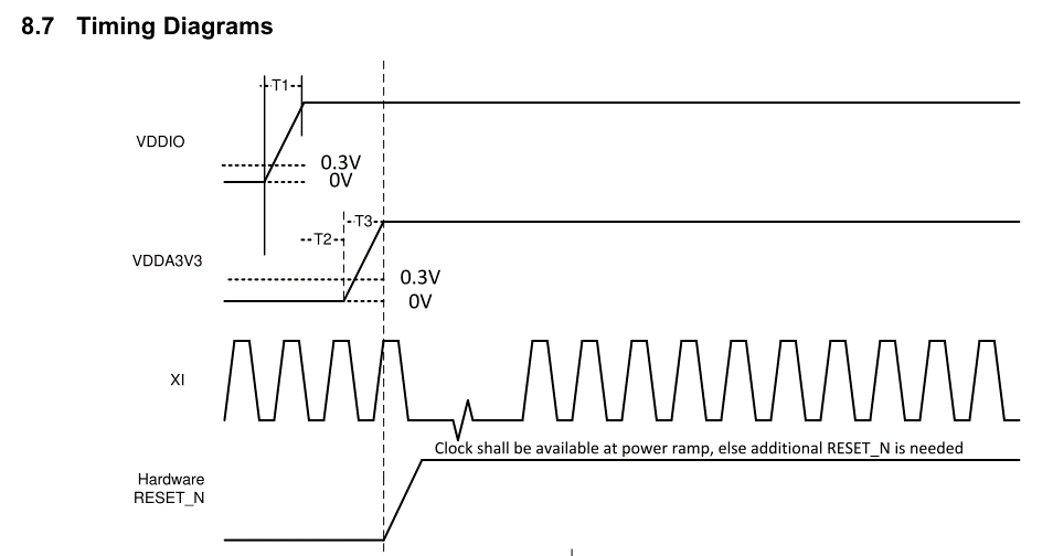

(2) About the power supply sequence.
In customer's application, the clock is not input to XI during 3.3V power rising.
I belive the following sequence is required to keep the instruction "Clock shall be available at power ramp, else additional RESET_N is needed".
1.  3.3V power supply (VDDIO, VDDA3V3) turns on. At this time, XI pin is fixed at 0C.
2. Clock input to XI.
3.  Reset release (Hardware RESET_N rise)
Is this sequence correct ?

    1) DP83826 and DP83822 are different design but both are targeted for industrial applications. Some of the differences are temperature grade, ESD, and Fiber Ethernet support.
    2) The power sequence outline above is correct for powering the DP83826.
