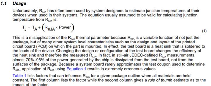

Part Number: HD3SS3212
Team,
What is the junction temperature for HD3SS3212I? The datasheet only specify the the operation temp only.

Hi Andy,
Ta limits is specified in the 4.3 Recommended Operating Conditions section of the datasheet and Tj can be calculated using the below.
Reference: https://www.ti.com/lit/an/spra953c/spra953c.pdf?ts=1591962507481
