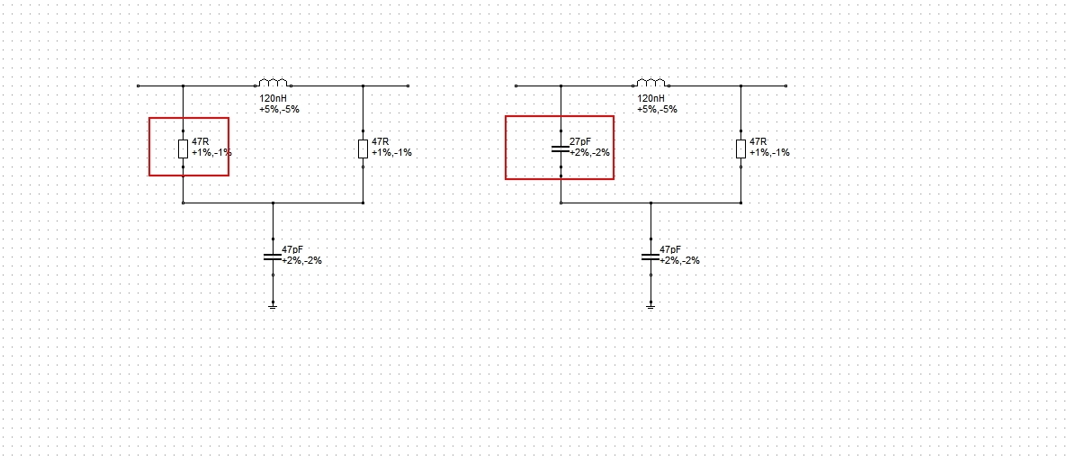

May I ask as for DP83TC811S-Q1 LPF, which one should I refer to?
The left is CAR OEM's PHY standard, but the right is the recommendation circuit in TI document.
These two are pretty different, which one should customer refer to?

Hi Amelie,
Do you know the source of what is in list of CAR OEM's phy standard? We should refer to what is in the datasheet.
