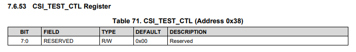

Hi, I'm trying to qualify our CSI-2 links out of the DS90UB954-Q1 by capturing the eye diagrams on each lane. I would like to have the CSI-2 outputs enter high speed mode and then transmit arbitrary pseudorarndom data continuously.
- Is it possible to configure the DS90UB954 to output the pseudorandom data it receives via RX port 0 via a connected DS90UB953-Q1 when in BIST mode?
- Can the CSI-2 pattern generator be configured to output pseudorandom data?
- Failing these two options, what is the closest we can get to generating a 100% duty cycle pseudorandom pattern on the CSI-2 outputs?
