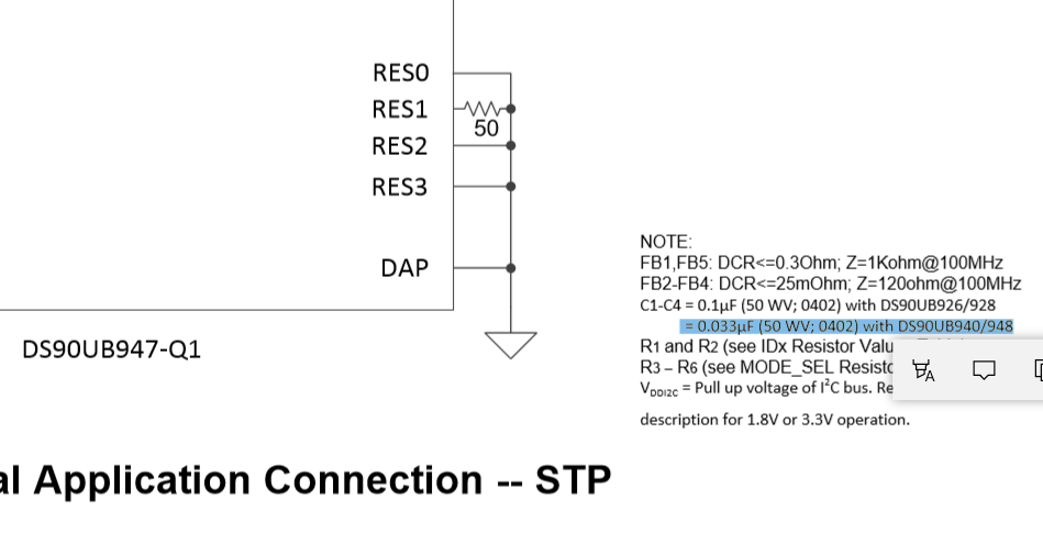

Could you please review attached schematic?

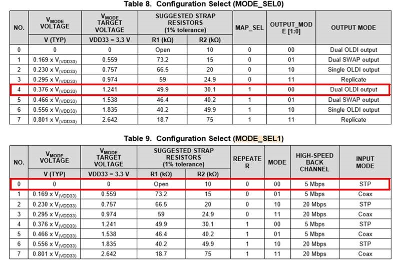

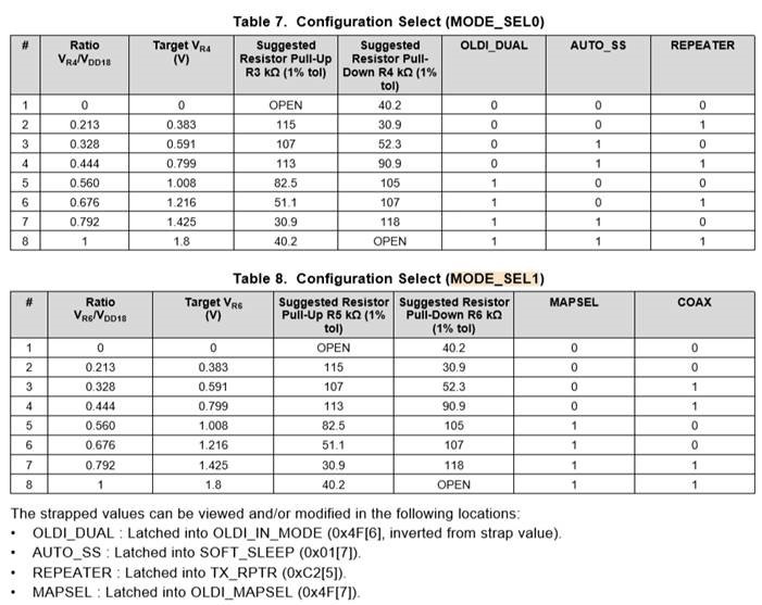

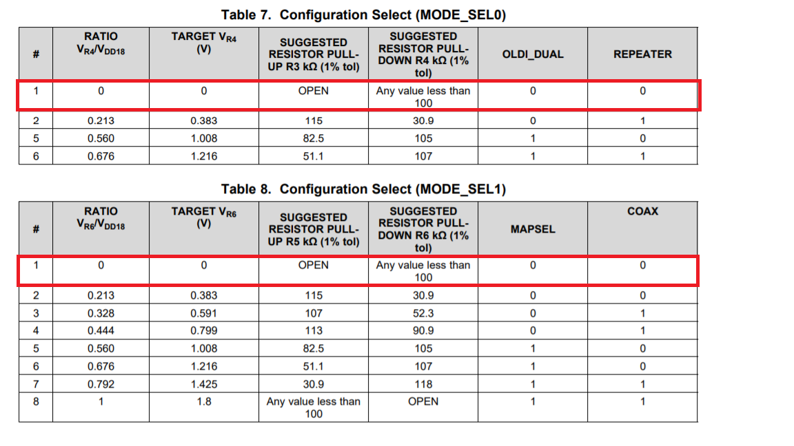

Hello Dexter,
It looks like you are using an old datasheet. Please download the latest datasheet from here.
https://www.ti.com/product/DS90UB947-Q1
For 947 I believe you are using the MSB on Data lane 3, correct? If correct then your MAP_SEL settings shall be 00 in both tables.
Hello Dexter,
If you are using the MSB on Data lane 3 and just 1x oLDI interface, then this setting is correct!

Hello Dexter,
I have checked your schematic. Everything looks fine to me.
Just one suggestion, you may add a place holder for an CMC on DOUT+/- for improving EMI, on a system level, if needed.
Hi Hamzeh,
you mean CMC is ceramic cap?
could you advise me detail how to add a place holder for an CMC and value?
Thanks.
Dexter,
CMC is a Common Mode Choke. You can use the one from our reference design. This can be found in this document.
You may add x2 0ohm resistors on the CMC footprint to have the options of using CMC or using 0 ohm.
