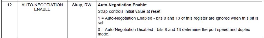

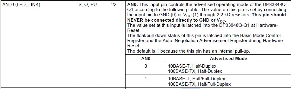

I have a question about ethernet link establishment between DP83848Q - DP83849I.
It takes "2s" after reset DP83848Q and then LED_LINK becomes active with below combination.
DP83849I - DP83848Q
It takes "150ms" after reset DP83849I and then LED_LINK becomes active with below combination.
DP83849I - DP83849I
could you let me know the reason why DP83848Q - DP83849I LED_LINK takes 2s and how to reduce it?
