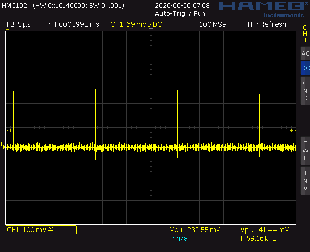

  • Hi David,
    I set Register 0x5F to 0x20.
    please see here the scoped signal on GPIO3:
    It has ca. 1Mhz. This is the signal on the DSI side, right?
    Unfortunately the GPIO is routed to an standard header, so I'm not sure how much the routing will influence the measurment.
    Mark
  • Mark
    Please see Figure 15 of the DSI86 for the DSI video transmitting diagram.
    HSYNC frequency = Pixel Clock / Htotal = 188.12/3180 = ~59.16kHz, this should be the panel requirement. If you are measuring 1MHz, then the source is sending the video outside the panel requirement.
    David
  • Hi David,
    I tried again and I think I got the right measurment results. I tried now 2 different resolutions:
    1. The problimatic one 2880 x 960 x 60Hz with 24Bit
    -> The Debug output from my panel is:
    MSA is stable..
    H_TOTAL:3180
    H_ACTIVE_START:163
    H_ACTIVE_WIDTH:2880
    H_SyncWidth:33
    V_Total:986
    V_ACTIVE_START:7
    V_ACTIVE_WIDTH:960
    V_SYNCWIDTH:2
    PixelClockHz:188MHz
    ColorDepth:0x1
    ColorFormat:0x0
    H Sync Polarity:0
    V Sync Polarity:0
    The Scope looks like:
    The frequency is about 59kHz. This matches your calculation. So the data seems to be okay, but the picture is very unstable and flickering.

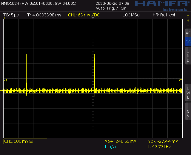

    Then I tried a second resolution:
    1920 x 720 x 60Hz
    The Debug output of the panel is:
    MSA is stable..
    H_TOTAL:2056
    H_ACTIVE_START:88
    H_ACTIVE_WIDTH:1920
    H_SyncWidth:32
    V_Total:729
    V_ACTIVE_START:6
    V_ACTIVE_WIDTH:720
    V_SYNCWIDTH:2
    PixelClockHz:90MHz
    ColorDepth:0x1
    ColorFormat:0x0
    H Sync Polarity:1
    V Sync Polarity:1
    The scope looks like:
    The frequency is about 44,4 kHz. The picture is very stable.
