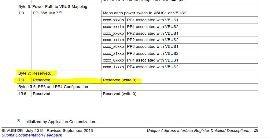

I'm seeing that the tool allow you to configure "Power Duo Mode". What is this bit [52]?
Bit [52], according to the spec I have, is reserved.
It seems like the bit was meant to configure Byte 8 bits [3:0] to dedicate PP to certain VBUS, which is exactly what I'm looking to do.
Could you please confirm if it's a documentation or configuration application issue or perhaps my misunderstanding?
How can I change PP_SW_MAP during boot (not run time register change)?
