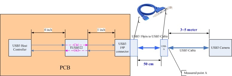

Hi Sir,
In my design I use the TUSB522 to enhance the USB signal quality. My application is shown in below, it's used for camera video capture. The TUSB522 setting is shown below too. When video capture is running, sometimes the USB host controller miss the camera device or get error video. It seems the USB receive quality isn't good enough. Please help to tell me how to adjust the TUSB522 EQ/DE/OS to overcome my issue. Thanks a lot.
1. Current setting in my TUSB522. Test 1 and test 2 are failure in camera capture video.
Test 1:
EQ1: 9dB
EQ2: 6dB
DE1:-3.5dB
DE2:-6.2dB
OS1:0.9Vpp
OS2:0.9Vpp
Test 2:
EQ1: 9dB
EQ2: 9dB
DE1:-6.2dB
DE2:-6.2dB
OS1:1.1Vpp
OS2:1.1Vpp
2. The SI compliance test of USB is PASS in Measurd point A.
