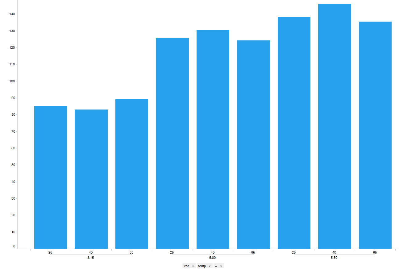

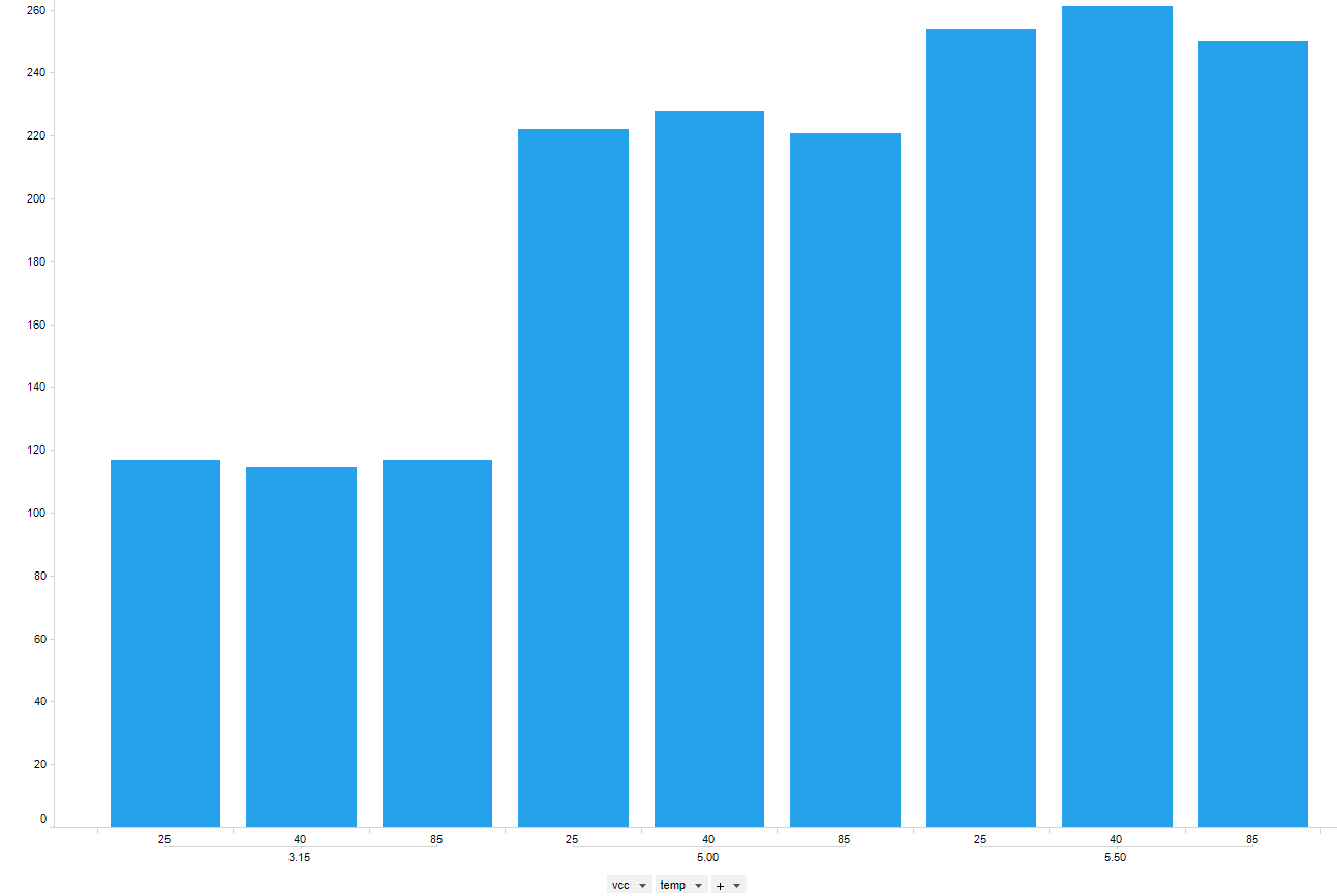

Do we have propagation delay, rise time and fall time vs temperature variation graph for SN65HVD1781DR?

Looking at the plots, we consider that for Vcc 5V, rise/ fall time varies between 210us and 230us over temperature range -40degC to 85degC. Similarly, propagation delay varies between 125us to 130us over the temperature range.

Prachi,
Yes, the unit is nanoseconds. The data are within the specification of the datasheet. Please let me know if you have more questions.
