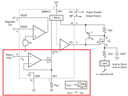

    - about pin SET (R set) : at this pin mirroring actual measure current loop? or only mirroring Vin?I want to clarify how the SET pin works. If Vin = 1V and Rload not connected, what will be on the SET pin? I would also need feedback from the current.
    XTR111 is V-to-I converter with current mirror circuit driving above the feedback circuit, see the attached image in red. So this is precision V2I converter with voltage feedback above Rset. The mirror circuit will duplicate the driving current (left branch) and source as needed at the Rload on the right branch. If Rload is missing (similar to infinitive resistance), and it will only affect the right current mirror branch, where the output pin is likely pulled up to rail voltage without load.
